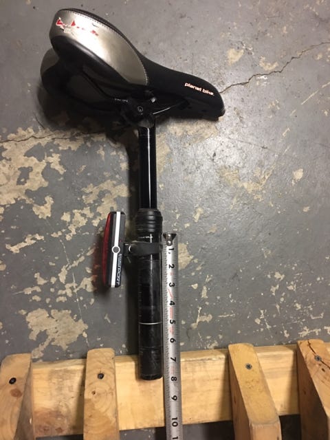

Hi:
Looking for a dropper post with the shortest possible base -
"Base" defined as the bottom of the dropper post till the collar, like so:
Issue I am trying to solve is that the existing dropper post on my wife's bike wont go all the way down the seat tube because of a kink/angle in the frame's seat tube. The collar of the droppar currently sticks out 1.5" from the seat tube, preventing the seat from dropping as low as possible to the seat tube.
The current "base" measurement is 7.5" (190mm) and I need one that has a base in the 5.5"-6.0" (140-150mm) range in order to reclaim the 1.5" of drop that is lost due to the kink/angle in the frame.
