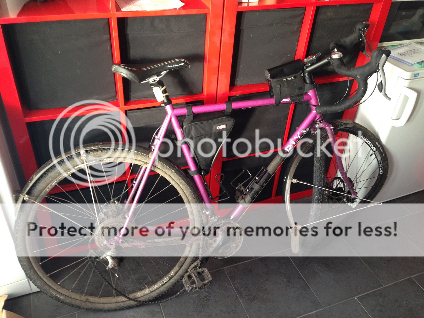

It's very sad, 'cause I want to use 29x2.1 tires, like Nokian Extreme 294 studs (as on this bike).
I read many reviews of CrossCheck, where it was mentioned that 29x2.0 tires can be used. I think, that Straggler has room for tires with width more than 2.0.

Not in the rear triangle it doesn't. A slick 2.0 is the largest you'll be able to squeeze in the back, for sure. And better to use a skinnier rim - even then, if your wheel goes out of true, you'll be rubbing.
Panaracer 45mm firecross fits like a glove though, if you want to go nobby. A 45mm slick with fenders should fit nicely. As for studded tires, you should be ok with anything in the 38-45 range.
As for clearance pics, check back in this thread somewhere around page 25 or so (give or take a few pages) and I believe efuss has some pics posted.
^ Correct. I also have pics posted in this thread showing the razor tight fit my 2.0 slicks have.
It was so tight I got sick of the maintenance and put black 35mm tires on it.
