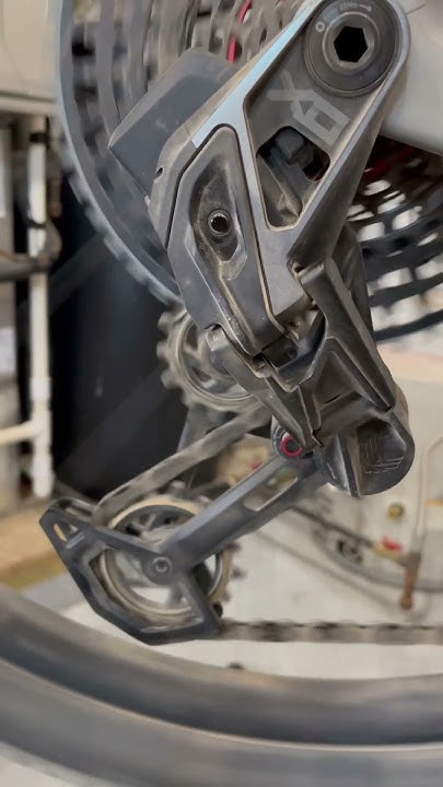

6. Undo the mounting bolt on derailleur with 8mm Allen (normal threading lefty loosey and all) and put the red bushing into the empty UDH hole on the rear swing arm. Put derailleur over the swing arm mounting area and insert the mounting bolt. Righty tighty until snug and then back off 1 full revolution. (little grease on the mounting bolt) Extend the derailleur cage all the way down to service position, same as all previous EAGLE and push set up button key to lock it. Install rear wheel with cassette installed and tighten the axle to firm and back off 1 full revolution.
7. Thread chain in as you normally would and lock the link with chain pliers. Obviously here flat top up. Chain is threaded around the 21T cog, through derailleur and around chainring. Then push the case forward like you would to unlock it from service position and release slowly so you can push it again (same button) for the next opening where a little A and B line are. This is for set up. Once here grab the lower jockey wheel cage by the little trapazoid guard at the bottom and pull it until the chain is tight and tighten the derailleur mounting bolt to 35 N-m. The line on the metal knurled washer and the derailleur bracket will line up if you have the right chain length, chain stay length, set up key position, and set up cog noted in the pic above for your bike.

#35 ·
1. Installed DUB BB with no inboard spacers, a 3mm outboard non-drive side spacer, a 5mm outboard drive side spacer. (my bb measures 75mm with the ISCG plate, if you have a standard 73mm shell you must use a 3mm non-drive and a 7.5mm drive side outboard spacers)
thank you for answering the question I came here to ask, seems like the new chainline is considered mtb wide longer spindle cranks, I hate that sram doesn't make this clear in their instructions
so are the new chainrings 0mm or 3mm offset in the sram cranks? 7.5 drive side is 3mm wider than the original eagle cranksets, so you would still use a 3mm offset chainring for a 55mm chainline is that correct?
#36 ·
They are MTB Wide spindle and 3mm offset chainring. Same as Eagle with a 55mm chainline. Same spacers with the same Dub BB.
Big change is the different cassette spacing, 2.5mm outboard. Makes the chainline perform similarly to the 52mm line of the standard-spindle Eagle.
#44 · (Edited)
Weird noise started on my last ride, seems to be on a specific short part of the chain, I can’t see any damage to the chain visually, but I’m thinking I might need a new chain, still might try a full re install
EDIT: this seems to have been dirt, bike wasn’t really dirt trails have been dry, but apparently there must have been some dirt or sand in the wrong spot
#45 ·
Just noticed this, can’t say if it was always like this or somehow after some riding, I have a 32 ring and my chain is touching the cage when in the highest gear smallest cog
Anyone seen this?
