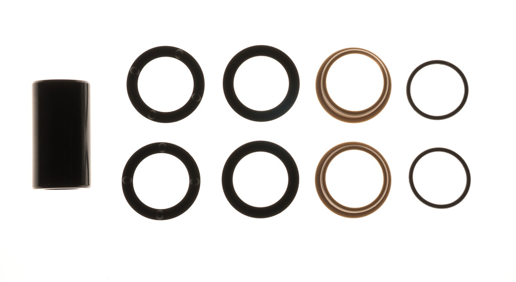

Question—
To switch from the air shock to the coil shock I need these pieces (reducers?).
The frame spec page says this:
Is this what I need to buy?

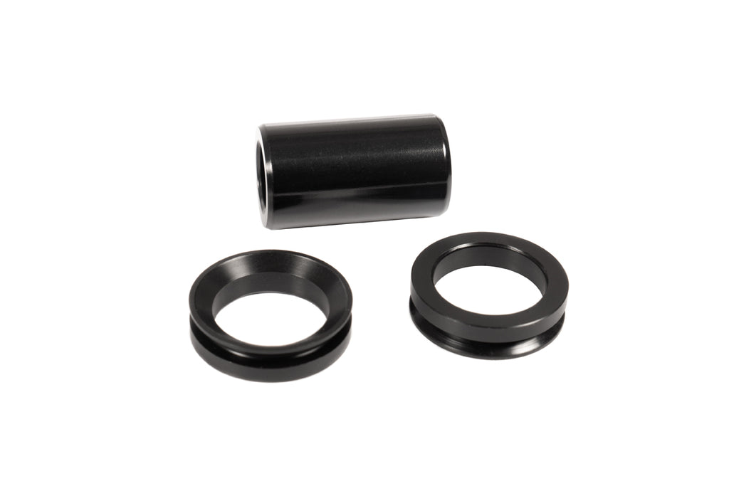

Question—
That’s what you need to buy. I noticed that Fanatik is out of stock. So then I looked at LostCo and Worldwide Cyclery. They’re both out of stock too. I stopped looking—you can look yourself! But, you should be able to press out the hardware from the air shock and transfer it over to your coil if you’re not able to find what you’re looking for in stock anywhere.
Is there a good way to press them out without marring them up?
These have gotten really inexpensive...
Before I got that tool kit I just used a vice and a socket set, with some care you can do it without scratching anything. It doesn't take that much force to r&r the hardware.
That tool kit is for bearings but could work for this, may need to use a socket or something to get more travel.
EDIT, also this...
Fox hardware will work too, rockshox seems to always be out of stock but the fox stuff is usually in stock. RWC also makes a kit you can use
Yup, was just coming back to say this. Fanatik does indeed have the 8x30 that @Nat needs.
