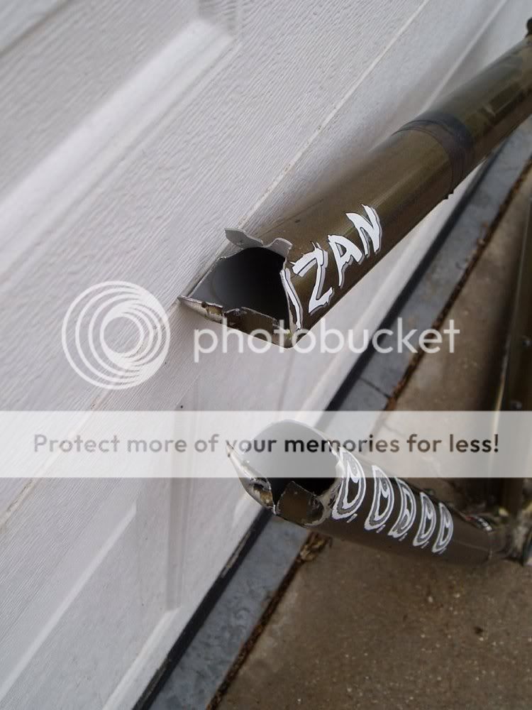

i personally would disagree with both of the above statements not only because al is made stronger by adding sc, but also from my personal experience. my stable includes three sc/al bikes (1 cross, 2mtb) and they have all held up just fine.
the xl kona kula supreme has lead a very, VERY hard life as evidenced by the less than pristine finish and assorted dents. it has been crashed hard more times than i care to even mention by myself and others, yet has held up to me (@200lb) riding it like i stole it including jumps and drops. and rigid at that.
both my kula and one9 have a ride that is very, very smooth and compliant and is quite noticeably different from 6k/7k series al frames. the one9 gets ridden very hard as well with not an issue one from the frame.
the cross bike is a bianchi cross concept with sc frame with carbon stays. it too has held up to rigorous riding, and has a light springy, compliant yet pleasingly stiff ride both on and off the road. sounds like a contradiction, but youd have to ride it to understand. it rides WAY nicer on the road than my custom ritchey road logic hand crafted from high end steel. in fact, upon adding the cross concept to the fold the ritchey was disassembled and is waiting to find a new home despite the fact that it was also relatively new to the stable at the time. the sc/carbon frame is just that much better.
So while I WAY prefer Sc to Carbon, it's by NO means "crash proof"...
NOTHING is crash proof. this failure occurred at about 25mph and wasnt caused by a crash, but did result in a crash...

youre not raining on the parade by giving your opinion. everyone is entitled to their own, even if its not entirely accurate. (request for flame... granted! :lol:)
im 6'3"/200lbs and ride very aggressively and have had problems with only one scandium frame, as you can very clearly see in my previous post. i feel the problem was overly thin tubes and/or inferior alloy. most likely inferior alloy for the most part.
the aizan in my previous thread got that way at cleburne state park on the back side big hills. went flying down the single track and at the transition at the bottom of the hill there was a little depressed area about 8 inches wide and 2-4 inches deep. when i hit the depression @ about 25mph i heard a loud pop and all the sudden everything went wonky. i thought i had broken the fork (surly km fork) but in fact has snapped the frame in half.
