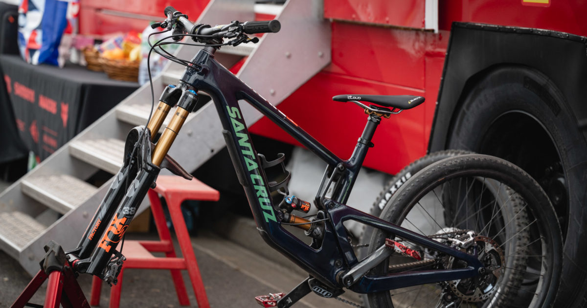

Megatower V2
I'm guessing the only real upgrade is more travel.
It's probably going to be a refresh more than anything. the V1 is three years old and a bit long in the tooth compared to modern geo.
I'm guessing it will be pretty close to what the new Bronson is in a full 29 flavor. A bit slacker HTA, bit steeper STA, tad longer reach, etc.
Edit: I'm assuming it will also have size specific rear triangle/chainstays as well, since the last few SC releases have had this.
