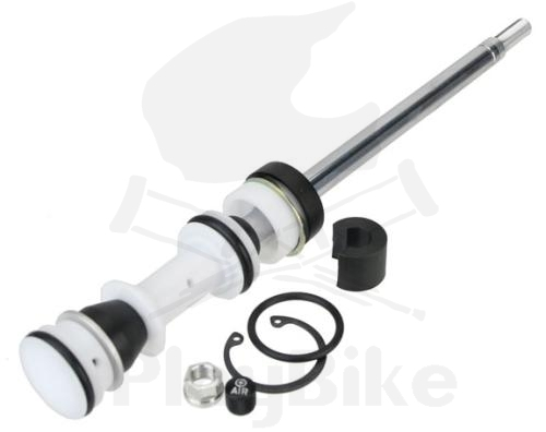

There are things you can do on the air side to increase the negative chamber size, again involving a bit of diameter reduction on the lower air spring seal head. I'll post up a few photos when I get home.
Discussion starter · #119 ·
This is the current layout of the air spring assembly at 150mm travel.
1936206
With this setup the o-ring of the negative seal head is around 20mm above the lower edge of the lower guide (which is secured at the bottom of the stanchion with a large circlip).
1936200
From the bottom edge of the lower guide to the bottom edge of the piston is around 86mm at topout.
1936201
At topout the negative chamber length, center of lower seal head o-ring to center of piston o-ring, is ~99mm.
1936202
You need a lower seal head from a pre-Debonair Lyrik for this modification. I have a bunch of these lying around, but if you get yourself the 200 hour Lyrik/Pike B1 service kit part # 00.4315.032.621 it comes with a negative seal head that seals right at the bottom of the stanchion, with the o-ring about 3mm from the bottom of the stanchion. This kit also comes with a set of low friction dust wipers which is a useful improvement on these forks.
1936203
For this specific modification you also need a 20mm travel spacer instead of the old 10mm spacer - I use a part from the Rockshox travel spacer kit part # 11.4015.450.000. Alternatively you can re-use the old 10mm spacer and the 5mm rubber bumper that sat in the old orange lower guide plus some additional hardware store o-rings.
Individual parts of the new assembly with ~150mm travel:
1936204
The new negative chamber length at topout.
1936205
The new Lyrik lower seal head has an external diameter of about 32.4mm...
1936209
...and you need to get it down to ~31.5mm to fit into the 35 Gold's lower stanchion.
1936208
That's where the additional machining comes in. I just use a threaded rod and two nuts in a drill with a sanding block (and gorilla tape wrapped around the rod threads where it sits inside the seal head), which took no longer than 5 minutes. If you do it this way, remove the seal inside the seal head first.
1936210
