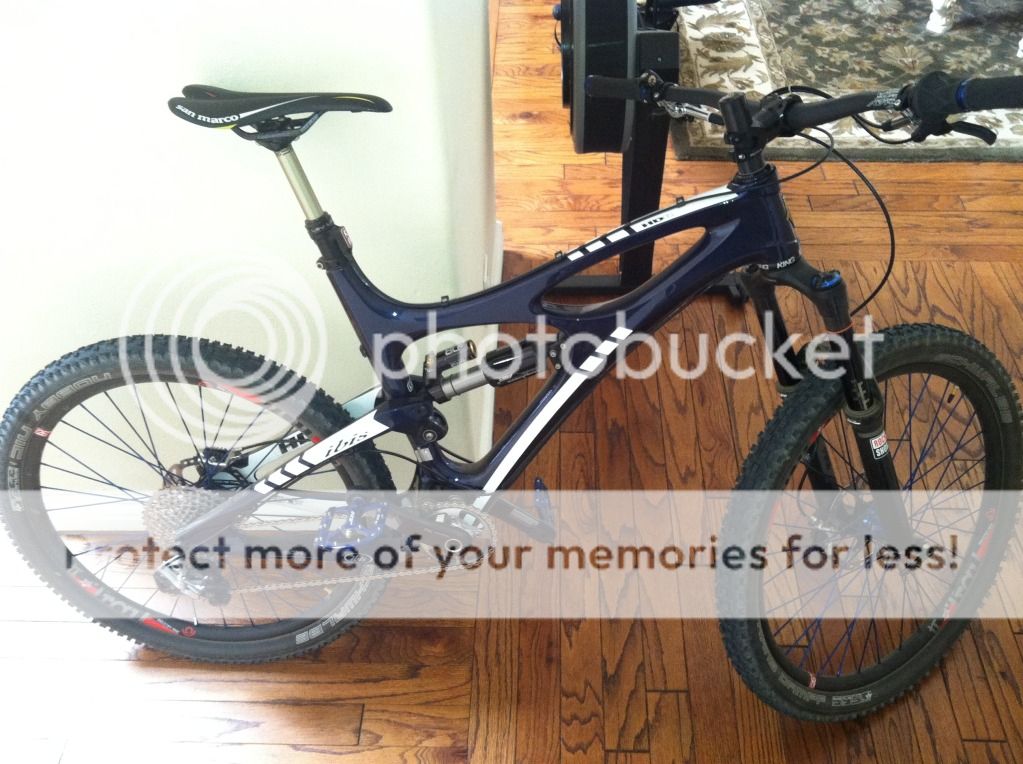

I posted this on the new Ibis thread earlier. I did not see this tread until last night.
Large frame with CCDB shock 160mm
Pike 160mm fork
I9 Trail wheels 26 inch
XX1 with Gripshift
XTR brakesj
King Headset
Lev seatpost
San Marco seat
Havoc Bars
Haven Stem
Hans Damph 2.35 front
Nic 2.25 rear
26.8 pounds
