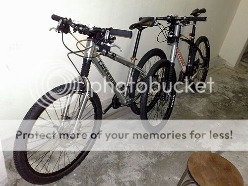

hi guys...just wanted to know which is the correct way to position them on yr handle bar?
is it the one infront or behind?
thks!
