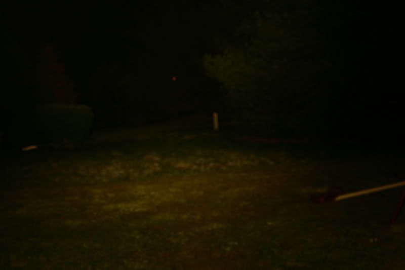

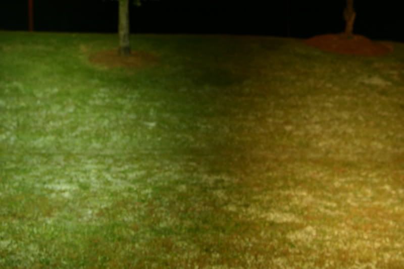

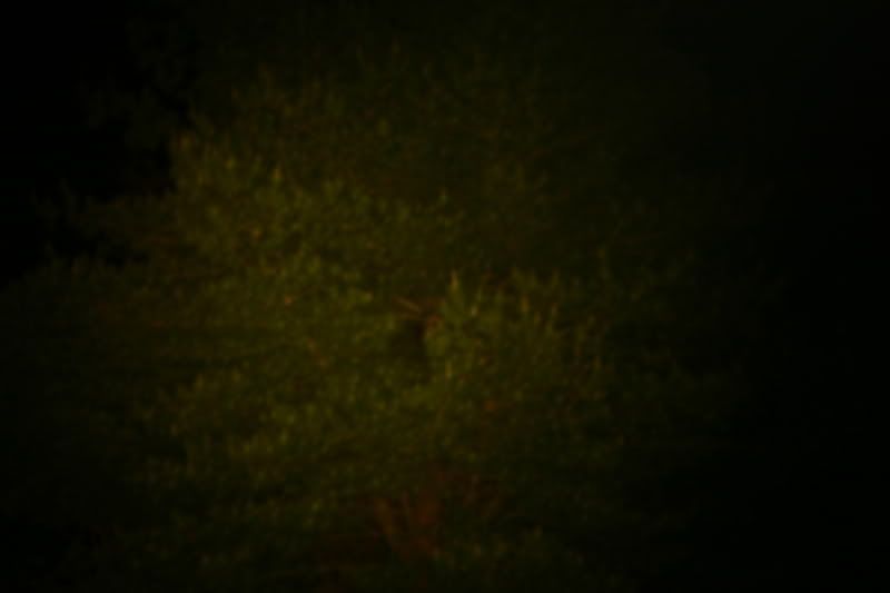

I took some photos of the two, but they aren't really all that impressive. The thing to remember is that the camera settings were the same, actually the same as in the LED light shootout, except the aperature was 5.6 instead of 4.0. And they are a little out of focus, but I am not an expert night photographer and rember the aforementioned Cinco de Mayo comment... Also take into account that the Jet light is using a fresh 14.8V battery that is actually at 16.75V when photographed, and the iBlaast2 is using a similar battery, but at a lower actual voltage. The difference is, I believe, the Jet can is actually using the 16.75V at the bulb, but dims slightly as the battery gets down to around 13V. I think the iBlasst uses the same voltage at the bulb regardless of battery voltage output.
The telephone post in the first two shots is about 175 ft away.
I'll try to get some better shots another day, but for now, maybe you'll get the idea.
Overall, I am very pleased so far with the light. The build quality is perfect and I will cry when I first scratch it. I'll get some more info after my first ride as well.
The Jet Phantom 20W with 14.8V Li-ion battery (actually at 16.75V when photograph was taken).
Same pic of iBlaast2 (with 15.5V li-ion battery at time of photograph).
Different shot of Jet light.
Same different shot of iBlaast2.
Shot of both lights, shining at same time, Jet on right, iBlaast2 on left.

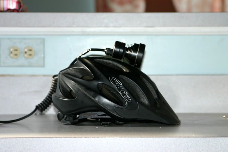

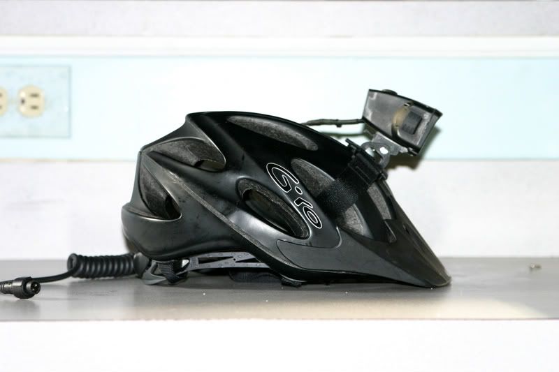

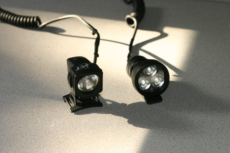

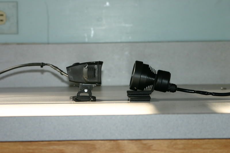

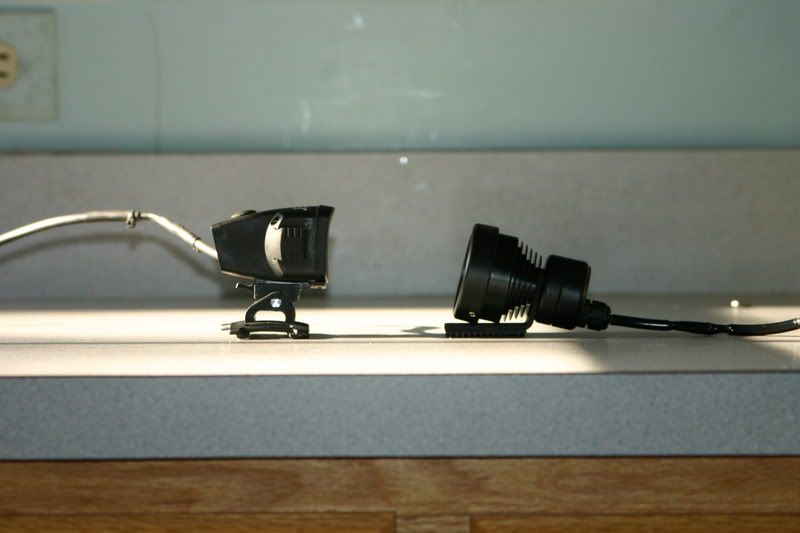

Here are some comparison pix of the two.
iBlaast2 on Giro Xen (without adapter, which may or may not be needed):
Jet Phantom on Giro Xen:
Side by side:
Head to head without adapter:
Head to head with adapter:
The adapter on the iBlaast looks like it will solve a problem with mounting lights on a Xen. The Xen has vents down the centerline of the helmet instead of a rib like most do. It has a rib down each side of the vents connected by two bridges. Without the adapter, you would need to mount the iBlaast on one of those two bridges. The Jet mount always felt to far forward on the Xen to me...the vents on it just aren't really condusive to mounting a light that uses straps. I'm not sure if the adapter will be necessary yet, it depends if the light will be aimed right on the bridges on the Xen.
