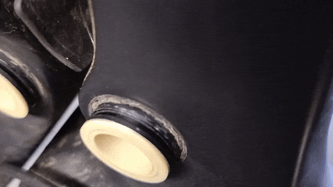

Keep an eye out for this failure Ripmo owners! This is the lower link housing separating from the front triangle on a 2023 V2S. I first noticed it when holding the rear brake and push/pulling on the rear wheel to check for axle tightness. There was noticeable play coming from the lower link and I wrongly assumed I was going to find some worn out bushings. I have a warranty claim in progress.
that looks like it is only bonded, probaby with high strength glue or epoxy? if so that should be repairable, i wonder if they do those. there was a thread regarding a similar issue but on a carbon turner, maybe the rxf and it was repaired under warranty.
