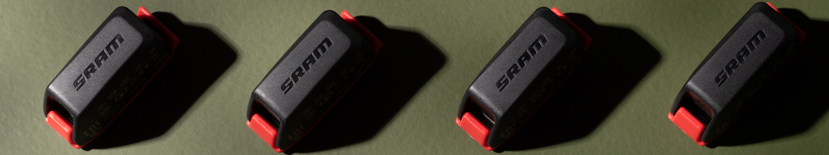

Anyone else's AXS Pod eats batteries like cakes? I changed the battery recently, rode less than 10km since, and the app says less than 20% capacity? WTF?
That sounds off. Are you using top shelf batteries (e.g., Duracell, Energizer) or cheap knockoffs? I bought some Amazon.com cheapies for our car key fobs and they didn't last long.
I think I have Varta now, but I don't believe it matters. All 2032 batteries cost virtually nothing, there can't be a difference.
I think the stupid Pod doesn't really go to sleep.
