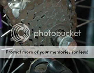

The PO sent me this picture. This is the lock-ring style... right?

Yep, lockring type. And those riveted pins are easy to punch out with a hammer and punch.

Right, except you will have to use the 11t or 12t cog as the last one, as the hole through the larger cogs is bigger in diameter and they don't have the ridged ring to mesh with the lockring ridges that "lock" it in place. And make sure you use that funky spacer (labelled "4" in the diagram above, used to clear the heads of the bolts) between the last cog that is/was bolted together and the smaller loose cogs, otherwise the spacing will be off between cogs 2 and 3.
