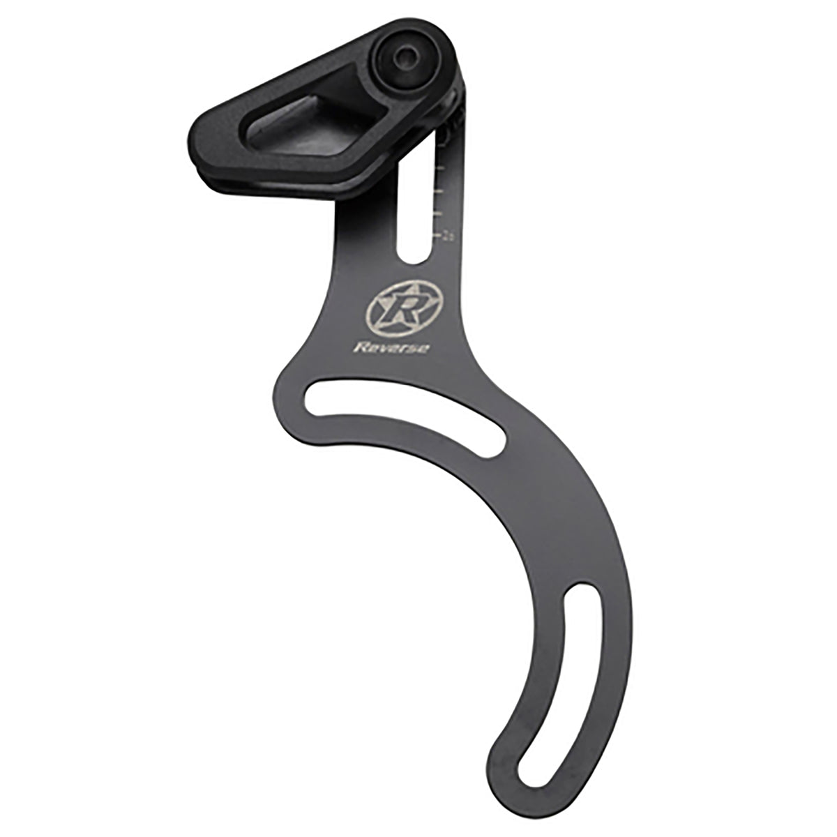

personally I’d try it without the guide and see if your clutch and NW ring are enough - but if you definitely need something, there’s this top guide that may be made to work:
