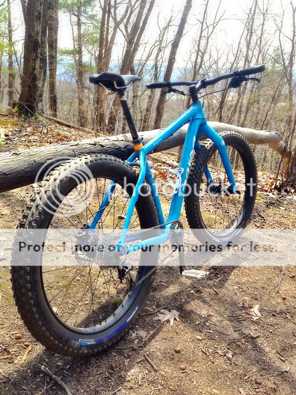

Saw a dude on the trail today who had a Salsa Fargo set up B+ with Hugos and 2.8 Trailblazers. Plenty of clearance there, MAYBE able to go wider. I didn't have a camera with me at the time, so no pics.
Fat B Nimble 9
Gen 1 Nimble 9 with FBNs on Velocity P35s front and back. Clearance is pretty minimal on both the fork and frame, but I haven't had any rubbing issues so far. I don't have a gauge that reads well at low pressure, but my best guess is I'm running them between 20 and 25 PSI. Tires have around 60 miles on them and have been inflated for over a month, so I don't think they'll grow much more.
Pedal strikes have been an issue, but I think most of that is because my fork is set at 100mm. I just outfitted it with Crampons on 165mm cranks. I think that should solve most of the problems, but I plan to set the fork at 120mm to raise the BB a little more and slacken the front end.

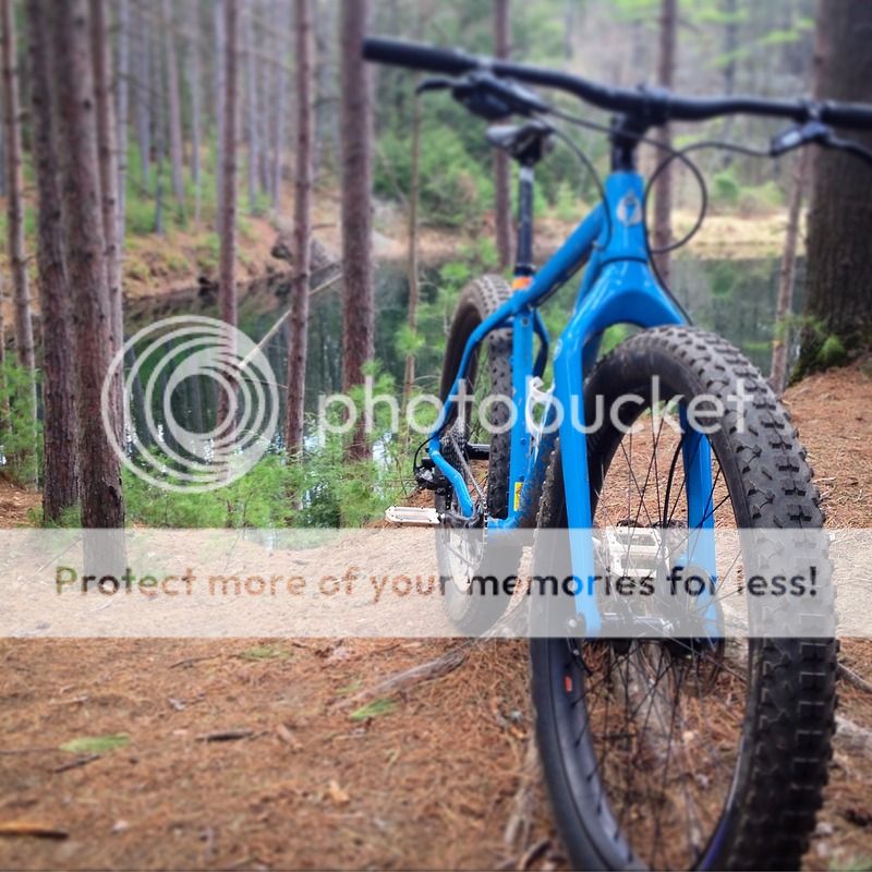

Titus Fireline EVO
Setup my Titus Fireline EVO with WTB Trailblazer 2.8's on Derby carbon hoops. Plenty of clearance. Thinking I might try out a 3.0 next.
