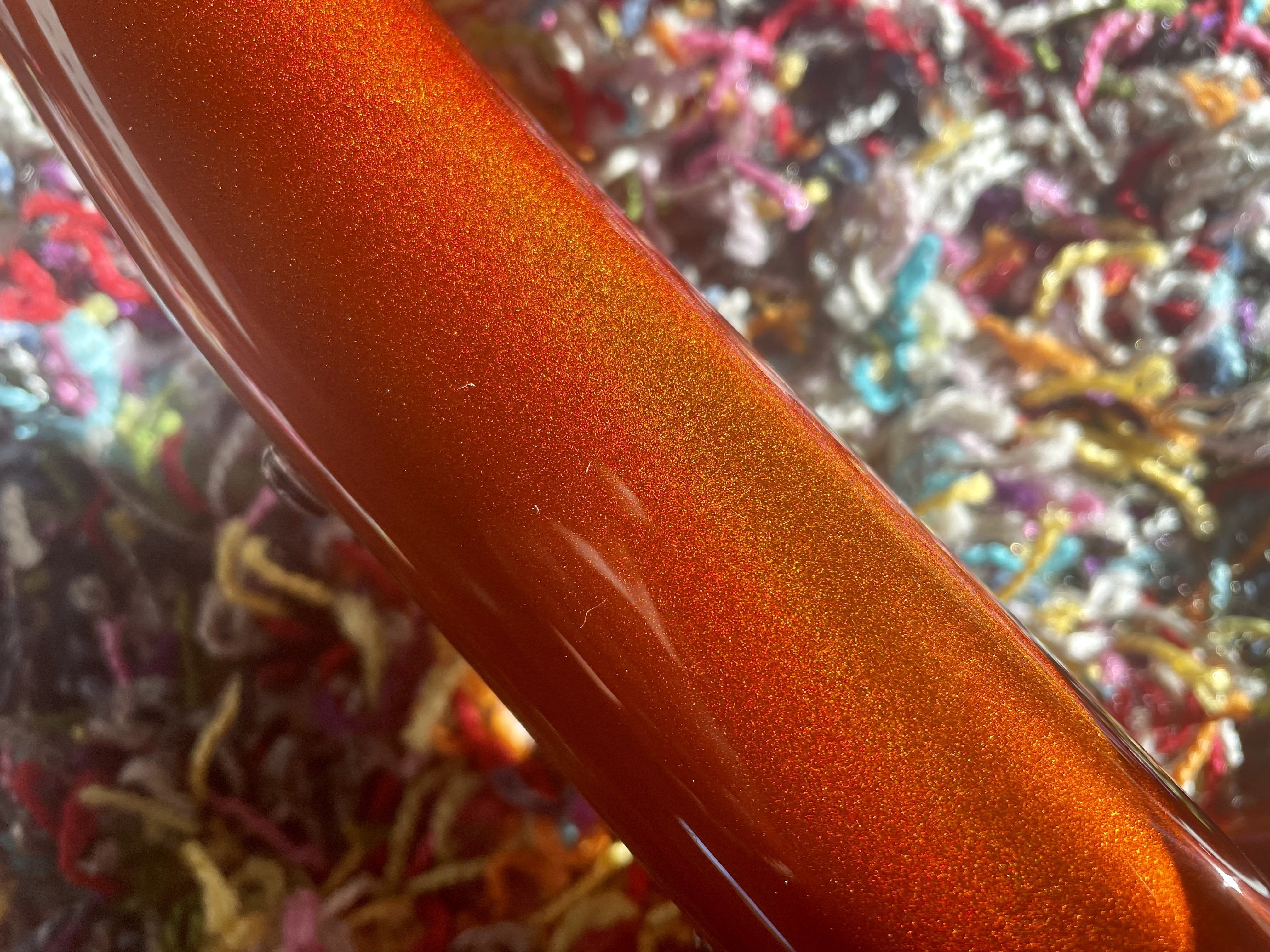

I managed to look at the Specialized website at just the right time, and pulled the trigger on the S-works frame, in rust! It was the only option left, and although not my first choice, it has grown on me. Now the fun part - putting parts on it. Just a quick q - which Shimano post mount to use for a 180mm brake rotor on the rear? It will have Shimano XT, 4-piston brakes. I assume the native size is 160mm, since that's the minimum size listed. If anyone has the stock s-works build, it should have a 180mm rotor on the rear.
I will post the full build when it's done!
