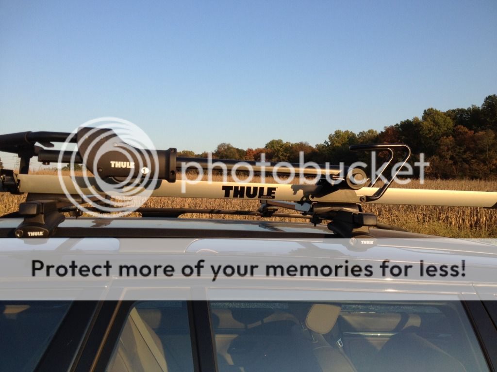

#7 · (Edited)
I like the design and ease of use that the side arm has but it looks ridiculous folded up, while the highroller is still pretty compact and aerodynamic when folded. Anybody recommend one over the other?
I can't suggest one over the other, but I recently got a sidearm and like it very much. Its a very sturdy rack and a bike mounts up in less than 30 sec. Every vid of the Yak that I've seen seems to show a mounted bike teetering from side to side once the car is in motion. Now THAT looks rediculous to me. LOL. See the beginning and the 3:33 mark of this vid, for example: Yakima FrontLoader Wheel Mount Bike Carrier Review Video | etrailer.com
Whereas the Thule mounted bike remains rock solid.
The look of it in the folded position never even occurred to me. I had no idea it looked ridiculous (but hey I ride a Lefty, too!). Its a roof rack. By definition, any rack kills a car's aero.

Whether ugly, beautiful or inbetween (it's all subjective after all), I just had no idea that roof rack aesthetics (when not in use) were important to people. Not that there is anything wrong with that.
In my eyes, form follows function. A good sturdy rack that also allows quick easy "touchless" wheel-on mounting is going to have some beef to it. That beefy aesthetic is much more pleasing to my eye than a bike teetering on one's roof via a minimalist rack that folds to a low profile when not in use.

I don't care for the Highroller either but that one takes the ugly prize. The idea behind "form follows function" is a simple look. That one doesn't meet that test. Sorry.
I'm a BMW guy too (great car) - is that the x-drive version?
J.
I disagree.
While "form follows function" aesthetic design CAN result in simplicity, it can also result in odd, assymetrical, avant garde, complex, complicated or even "ugly" shapes that stand-out, depending on the desired function. It simply means that the desired funcionality of the component dictates the form it will take - not that the form will be simple or pleasing to the eye in a traditional sense.
A prime example would be some of the stranger-looking multi-link multi-pivot rear suspension designs on MTB's. Clearly a single pivot design is much simpler and perhaps more aesthetically pleasing for a bike frame design, but the desire for optimum suspension functionality often dictates a very different and much more complicated "uglier" look.
Thanks re the wagon. Its an e39 540it, x-drive was not an option when it was built. I have a 4x4 for the nasties, though.
