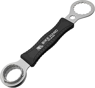

And will I need two different size bottom bracket tools for removal and installation? One for the large FSA and one for the smaller BB52? Or will something like this work on both? :

What about tje tool I posted. Will it work for both? Will I need two different tools? Are those cup-looking tools better?
You'll need the tool you linked for the Shimano bb install. I have the crescent shaped spanner tool and it has worked on Hollowtech, RaceFace and a few other similar brands.

The cup type bb removal tools will allow you to use a torque wrench to tighten to spec, with the spanner type tool you'd just have a good guess at tightening to around 40Nm.

I had to send back the tool I got from Amazon and get a different one. The second one worked on the both sizes. Got the one bottom bracket out , and the other installed. I hope the chain line is good. I guess I'll find out when I get the drivetrain installed. Thanks for all the help everyone.
