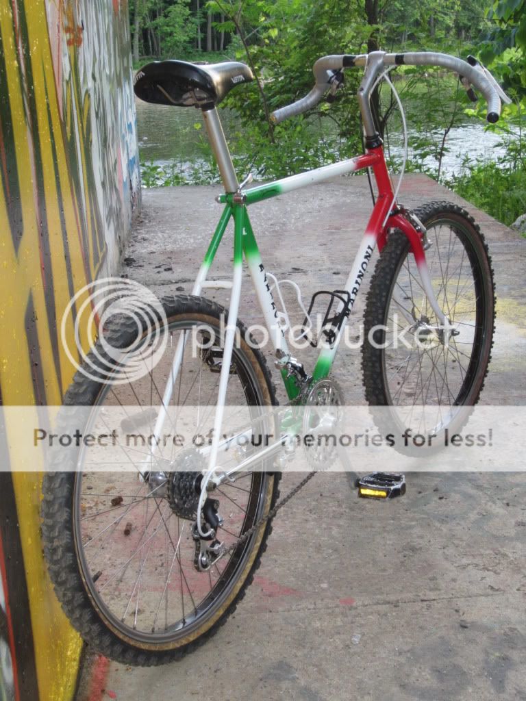

There are some drop bar bikes that are set up really well and some that aren't. I'm hoping the ones that are set up really well predominate in this thread. I see some bikes posted in other forums that are really bad and it would be nice for folks to be able to find properly set up drop bar bikes in one place as a reference of sorts. VRCers seem to have the hang of setting up dirt drops. I know there are a few styles of offroad drop bars, and people have different preferences, but generally proper dirt drop bar setup fall in a pretty narrow range.
Enough people ask about this topic in this forum, and you see plenty of people using drops these days on new bikes, how about nice repository for properly set up bikes, vintage or otherwise, with drop bars. Let's include links to external resources like Shiggy's and Guitar Ted's, good photos of 'proper' setup, philosophy, anything that will help the newb when they decide to try drop bars offroad.
