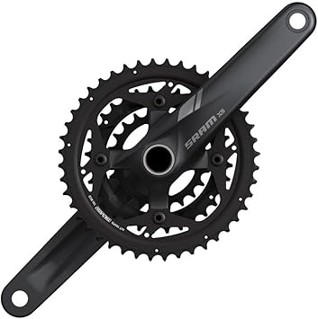

I'm looking to replace a Sram Apex 1 crankset on a Kona Rove: KONA BIKES 2019 | ROAD / GRAVEL | ROVE | Rove NRB. The gearing is just too high and i'd like something much lower (a 32 or lower). What can i replace it with that has a 104 bolt pattern?
Will something like this work? https://www.amazon.com/shanmashi-An...set-Integrated-Chainring/dp/B097MPF698/ref=cm_cr_arp_d_product_top?ie=UTF8&th=1
I know its a triple, id either manually change the front (if needed) or take 2 rings off (I like options).
#2 ·
You'd probably want to replace it with another SRAM crank unless you want to possibly swap the bottom bracket too. You'll also want to make sure you match the spindle length and diameter I'd look for a direct mount SRAM 1x crank with the same chainline and spindle specs as your existing one, then you can put pretty much any ring on it you want.
#4 · (Edited)
This one needs another BB, why don’t you look for another chainring?
According to SRAM it’s a 110BCD btw?

Would that Amazon bottom bracket/crankset i linked to work on this bike? There are a lot of hills out here, I'd like to have smaller chainrings AND do an 11-46.
