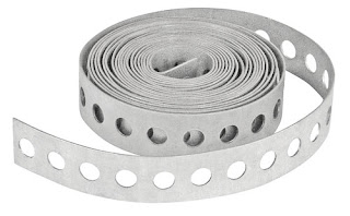

The hardware store has a roll of metal strapping with holes drilled every half-inch or so, about a half inch wide.
https://3.bp.blogspot.com/-YYQTz07QgiI/TcDD8jKYF8I/AAAAAAAAAsc/8A8KRMkWxI4/s320/PHI.jpg
Using slit rubber tubing for bushings to protect the frame and prevent slippage, make attachment points to the seatstays using the strapping and bolts.
