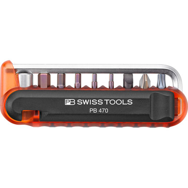

Hmm, my Daysaver bits are all rainbow plasma colored and say PB Swiss. Purchased in late 2020. That cracked bit doesn’t appear to be hardened steel? The current website has PB bits as after market, but it seems they don’t mention PB Swiss when describing the tool. I also believe I paid near 100$ vs 45$ current price.
#50 ·
I suspect the newer tools are not Swiss made anymore...
I'm not sure if the old bits are compatible, I'm waiting to hear back from Daysaver. I think that older tool is probably worth the price premium over the new one. I'm bummed but hopefully I'll be able to find some nested bits that will work. I assume people will lose these if nothing else.
#52 ·
Unfortunately, the bits are not 1/4", they are 5mm/ H5. I considered this as well.
They should definitely warranty that. Write them directly.
Official word from Funsaver: "tough titties, maybe some day we'll have spare bits for sale". Even correcting for Euro vs. US customer service expectations, this ranks pretty low on product support. I actually didn't request a warranty (though that was certainly my expectation), and I'd be willing to pay something to get this working again. The shrug-off is pretty disheartening.
Additionally, the magnet that keeps the bits in place has become debonded and fell out of the tool as well. As much as I wanted to like this tool, I've used it for all of two bolts and it has now failed twice. I was sort of contemplating ordering another one, but I really don't think I'll do that now. I'd probably not hesitate to purchase one of the PB Swiss manufactured examples, I'm sure those are well made.
From the Daysaver website, here is the info about fragility of the tool:
Sometimes it just takes force. The Essential8 lets you use it, with top torque values that will test your hands.
