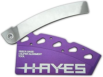

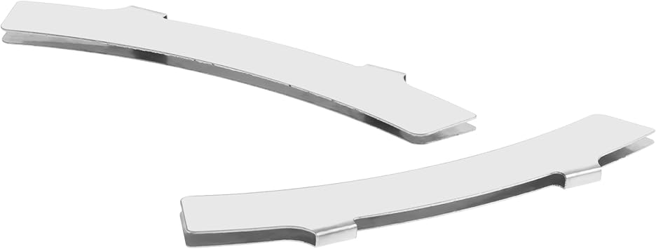

Put your bike on the floor and tighten the axle...then align the brake caliper and reset the pistons. See if that helps.
Using a caliper alignment tool can help too.
