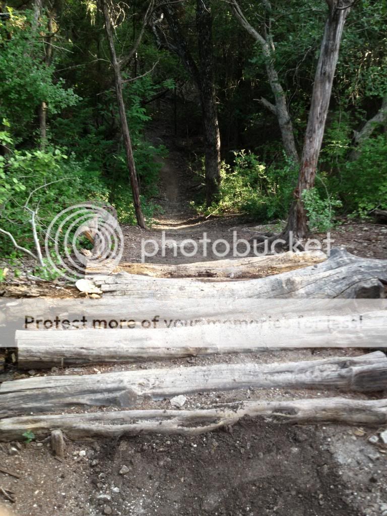

We built this at Pace Bend park skills area. I dubbed it "Rock Logster" (after the B52's song "Rock Lobster"). There were two boulders that you can kind of see, and the idea was to make a way to ride over them.
Because of the dirt packed at the bottom (a smooth entry transition), there have been a few guys hitting that and pulling up and basically jumping/skimming the whole thing.

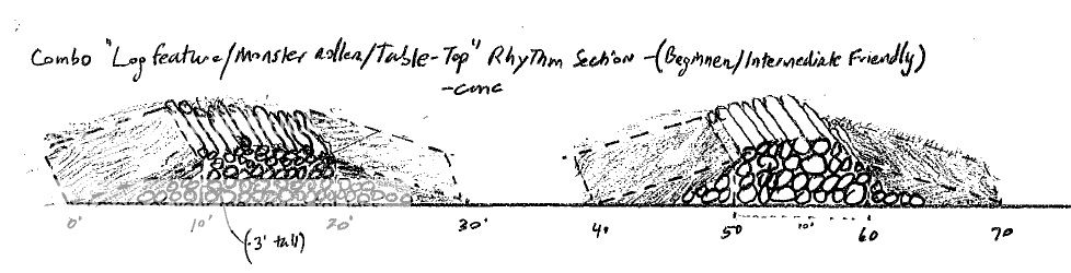

These pics are from Keystone. I want to mention the idea of the log-tabletop. It doesn't take precise engineering to secure the logs in there; once dirt is packed in and around them, they're solid. But leaving them somewhat exposed adds a little bit of ruggedness to it.
You'll also notice, in places like Ray's MTB Park, in Cleveland, they'll have a smooth up/down ramp then logs. The idea is that it's fun to have a smooth take off, then badabadabadabada over the logs, then smooth landing.
