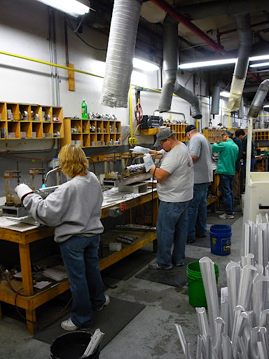

I don't think so Shig it's all a mater of what the glue is. I know a few Boeing engineer types that glue all kinds of things to their bikes. The couple companies I ever knew that switched from glue to rivets did so because it was cheaper and faster. The problem was mostly cure times. When I was at Cannondale last winter they "brazed" them because it was the best balance of speed and cost. Here's a pic of the brazing lineup.
