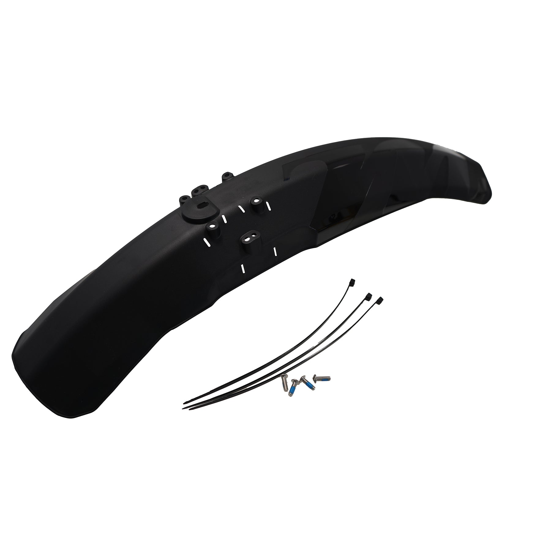

Im glad to say the guards swap between the two models fine, but I'd be interested in swapping the dampers (my 36 has a Dougal special that pisses on the new pro from a LARGE height).

The mud guard fits!
