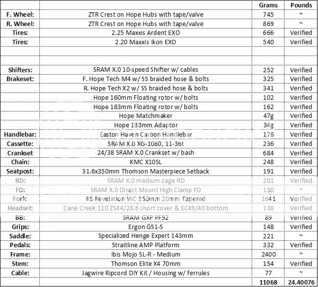

SLR built and ready for first ride...
Medium SLR - Silver (actual 2420gm* with seat binder and shock only)
Headset, CC angleset, 210gm*
Headset cap and screw, 20gm
Fork, EXM 150mm 15mm qr, 1680gm*
Wheels, haven carbon, 1440gm*
142 rear maxle, 74gm*
Tire, rear, Nobby Nic TR, 615gm*
Tire, front, Weirwolf 2.5, 915gm
Stans Fluid, 125gm
Handlebar, Haven carbon, 169gm*
Bar ends, silver, 25gm
Stem, RF Turbine 60mm / black, 136gm*
Grips, 60gm*
Seatpost, Thomson Masterpiece, silver 190gm*
Saddle, WTB Silverado, 210gm
Cable, Jagwire Ripcord Derailleur / silver / 110gm
Brakes, Magura MT8, 430gm*
Brake adapter, 12gm
Rotor, 180 SL storm 116gm*
Rotor, 160 SL storm 97gm*
Rotor bolts x12 Ti 16gm*
Front Derailleur, XO HO Direct Mount, 129gm*
BB /press fit, 70gm*
XX Crank, 652gm*
XX cassette, 211gm*
X0 10 shifter 125gm*
XO 2 shifter 126gm*
X0 Rear derailleur 202gm*
KMC Chain, 268gm*
Bionican chain guide, 57gm
Frameskin, 120gm
chain stay wrap, 50gm
xtr pedals, 325gm
* confirmed weights
Complete weight = 24.42 lbs.*
HA = 67.5
Impressions from test riding the street: Frame is uber stiff - feels very different from Classic; Pedals like a rocket ship (likely due to light wheels, stiff frame, and stiff XO/XX drivetrain); Front fork feels amazing; Rubber boot on crank was hitting the frame wrap so I removed the boot (156 Q factor is a tight fit); brakes feel progressive but not strong (I assume they need to bed in and maybe I need to bleed them better).... now for a real test ride :D
