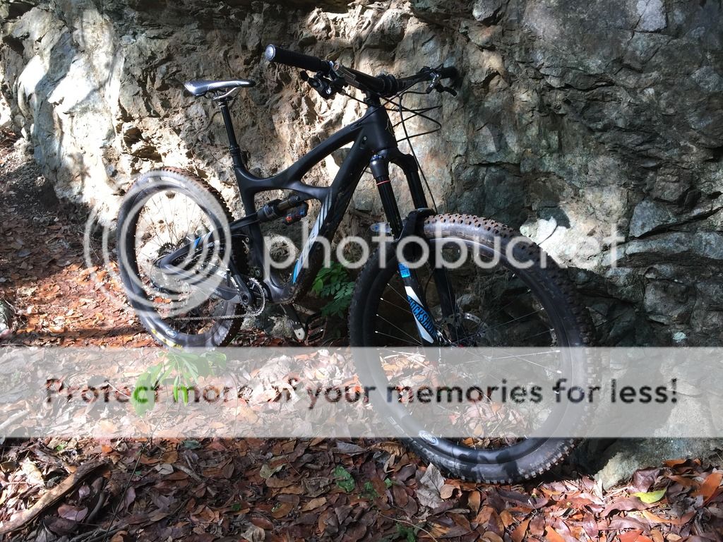

Went with a lighter weight trail build, for all day epic rides. Large frame, CC inline, XF Sweep, xt brakes, rotors, shifter & derailleur, XTR 1x10 (e13 42t), RF next crankset & 30t, ENVE bars & haven stem, reverb 125mm & SDG carbon circuit, Derby rims on Hope Pros, Spec Purgatory & GC tires. 27lbs on the nose.

Looks good! Do you have much time on it? How's the sweep, and are you running it at 150 or 160mm?
Very nice!
Thanks! Loving it so far. Sweep is at 150mm (swapped over from old bike & I'm too lazy to change). But so far so good. Doesn't feel skittish at all on loose chutes (just the opposite in fact) & I'm loving the incredibly precise line tracking. Time will tell, since our longer, chunkier tech trails are still under snow for a while, and that's where I'd expect the 160 to work better.
