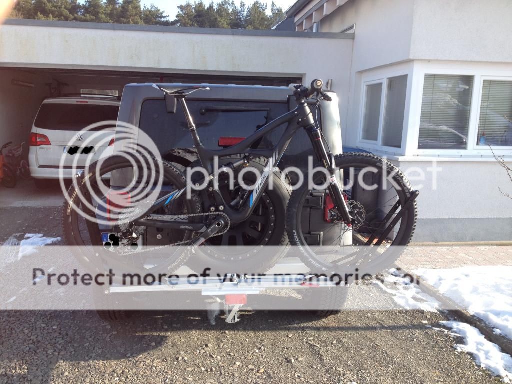

New bike means time for a new sticky thread! Here's my build, waiting on delivery of frame in December.
Frame: HD3, Large, Blue
Fork: Pike RCT3 160mm
Wheels: Chris King (red) and Derby Rims built by MikeSee (LaceMine29.com)
Tires: Schwalbe Rock Razor and Magic Mary Super Gravity
Brakes: Hope E4 Black 203F 183R
Cranks: RaceFace Next DM 32T
Rear Derailleur: XX1
Shift Lever: XX1
Cassette: XX1
Headset: Chris King I2 Red
Grips: ESI Racers Edge
Handlebars: RaceFace SixC 35
Stem: RaceFace Atlas 35
Seatpost: KS Lev Integra 150mm
Saddle: Chromag Moon
Everything but the Magic Marys (i'll run HRIIs till they come in), wheels and frame is ready to go.
What does everyone else have in the plans?
