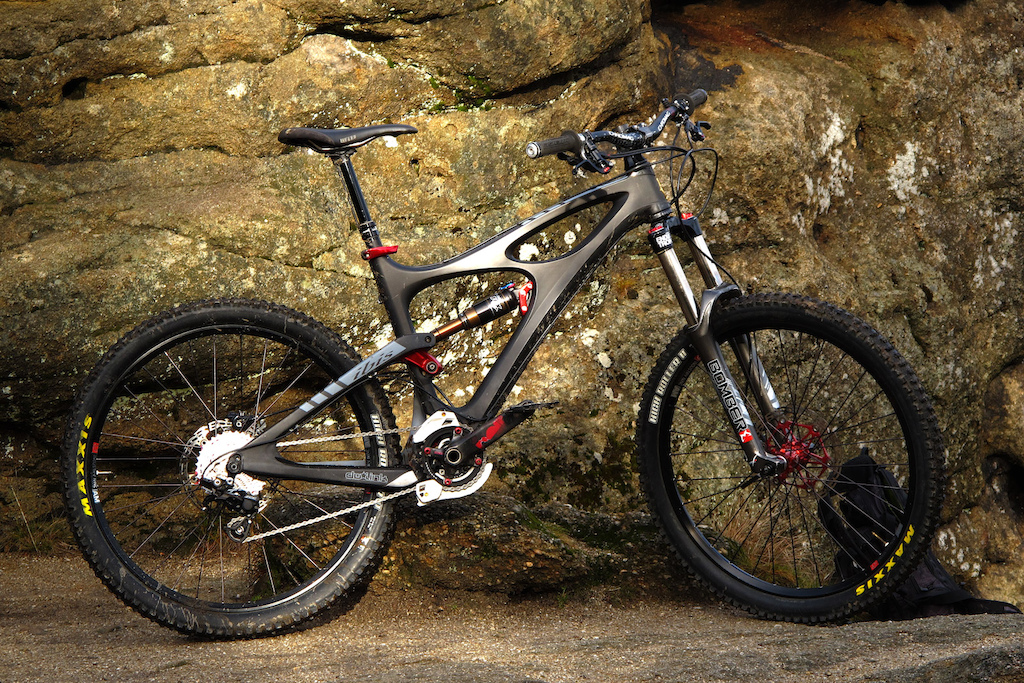

could you give me the exact models you are running on the heavy duty wheelset? thanks!
P.S, i weight around 70KG (150LBS) with riding gear on, so i guess i can get away with light wheels.
I'm 72kgs naked, a Dher ... ex-MXer but an old one :D
Those are my lights wheels for around home, for harder terrain (in the Alps or so) I ride Mavic Crossmax SX (but the ST could make it) with :
Maxxis Crossmark 2.25 LUST on rear
Maxxis High Roller 2 2.40 Exo on front (not an UST tire but used as is with no problem)
Lighter than yours, good rolling on the rear, and excellent grip up front !

edit2: adding another picture, because that's what these threads are all about :>
