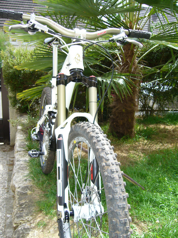

Yeah, Morandi pretty much sums it up for the 180 fork on the HD. I currently use a Marz 66 coil on mine and its alot of fun, more so on the downhills. Tech up hill climbing requires a bit more forward body movement but thats not such a big deal.
