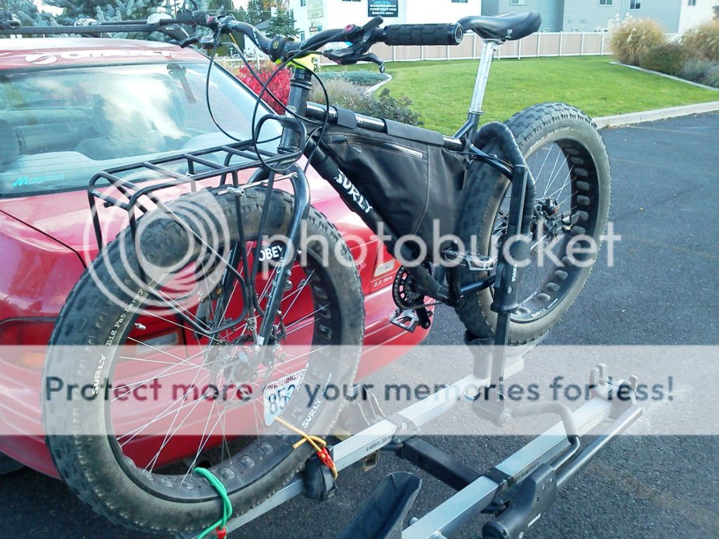

#11 ·
No mods. Used toe straps from an Enabler cage to secure the rear wheels. Did not release any pressure. (Only use less than 10psi ever anyway) This is a newer T2 with the longer arm. One bike has RD's with BFL
No issues ever with wheels creeping out of the tray.
