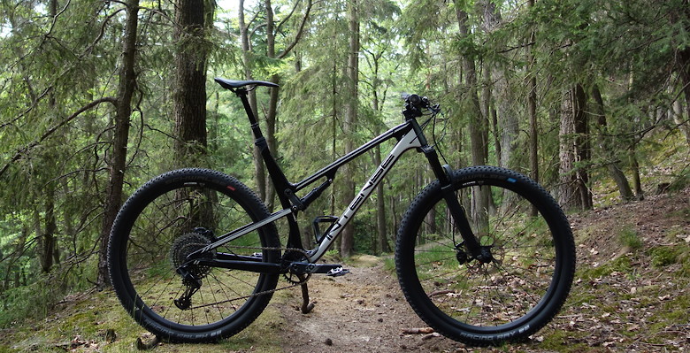

It seems there is a 165x45 trunnion model listed for sale now SKU: 192-36852-A012 (wasn't one when i looked 6 months ago) as we know these short shocks are generally jammed in small spaces on XC bikes...
Looking at this picture, there should be no issue on this bike.
As for the dimensions, use the search bar at the top, they've been circulating several times.
