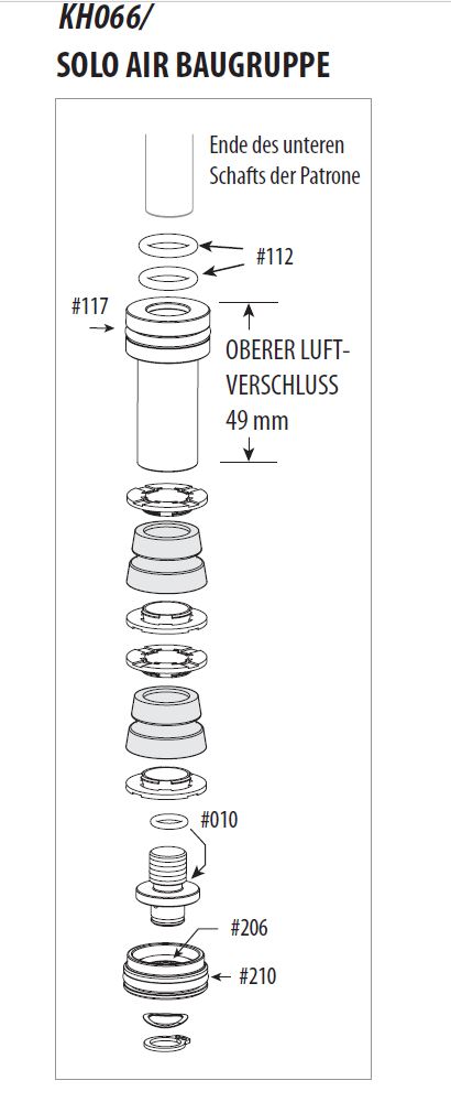

HI, I took my '15 XLR damper out and replaced all the seals no problem. I accidentally un-assembled the shaft and didnt see how the washers, damping washers and other small parts came apart. Im having a time trying to figure out how to reassemble the shaft. Theres also a small pen spring with a very tiny piece of aluminum that goes somewhere. I hope spmeone can help or has a diagram of how the parts go together. Thanks in advance for any help

Yes sir. I did the 2 spring update while I had it apart. Ive learned that the metal rod that slides through the damping chamber is call the telescope. Inside the damper chamber (where the oil lives) the telescope unthreads at the damper wave washers. It came aprt inside while I was working on it accidentally and I did not see the order in which it cam apart so I dont now the reassembly order. If I had a diagram of the insides I'd be set!

Give me a pic of the parts that you have disassembled and the damper so I can see where you're stuck. It sounds like the LSC checkvalve and spring and the blowoff shims and spings. However, it might be the compression and rebound shims stacks. Pics will help. There have been different iterations of valving over the years.
