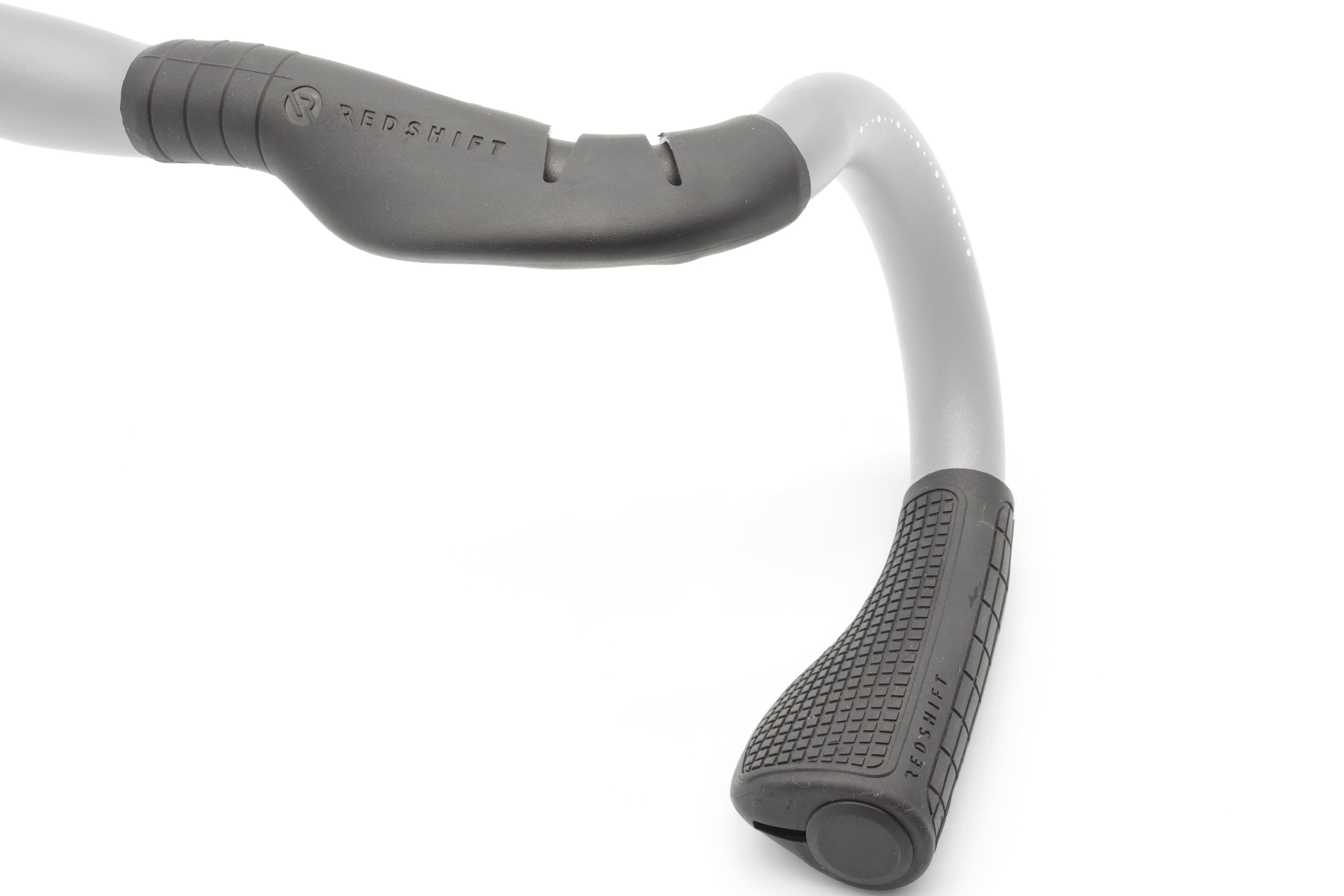

I am currently trying to find more methods, of adding ergo shapes to drop bars. So far I've found:
  • Redshift Cruise Control (the shape I am after)
  • Specialized BG Bar Phat
  • Ergon BT OrthoCell Pad Set
  • Fizik Bargel
  • Cinelli AVS Gel Pads
  • Planet Bike Century Gel Pads
  • Bontrager IsoZone Gel Handlebar Pad Kit - Trek Bikes
  • Bontrager Race X Lite IsoZone Handlebar Pad Kit - Trek Bikes
  • 3M 4008 closed cell foam, double sided adhesive tape
For the drops:
  • Ergon GA3, slim MTB ergo grip
  • Ergon GS1 Evo or GP1 Evo, both are more full fledged touring ergo grips
  • Wolf tooth fat paw XL (see here)
  • ESIgrips XXL 8.25" Extra Long Grips
Given a wide gravel bar, with fat grips needs significantly more tape. These are longer/wider rolls of tape I found:
  • Redshift Cruise Control Really Long Bar Tape (3mm, 30mm wide, 315cm per roll)
  • Wolftooth Supple Lite Bar Tape (2.5mm, 40mm wide, 152cm per roll)
  • Wolftooth Supple Bar Tape (5mm, 40mm wide, 152cm per roll)
The Redshift grip system looks like a pretty good solution, but I don't like the drop bar grip over the tape, the other two mentioned don't look thick/comfy enough for my taste.
All the other ones are only small inserts, that will not create a (hopefully good) ergo shape, I wish for.
There are apparently people 3D printing inserts with TPU, but I haven't found much good info about that. It seems like a great idea, but I would not know where to start with.
I also thought about putting an slim-ish ergo MTB grip (like Ergon GA3) on the drop, similar to the Redshift grip, but then tape OVER it. Not sure how well that would work out though.
Any ideas, or suggestions on this topic? I am surprised there is so little to find, regarding this.
TIA!
EDIT: Added more inserts/pads/and long bartape, as recommended by other users and my own findings.
The redshift grips go UNDER the tape, not sure why you came to the conclusion they go over. I run them and they add a nice broad flat to distribute the weight over. I also added the Fizik gel strips over them and the drops all wrapped up in some thick amazon bar tape.
I may have worded this poorly, when I said "drop bar grip". I meant the grip for the actual drops of the dropbar. That goes OVER the tape, or at least the end of the rubber overlaps the first 10mm of the tape.
I myself thought about putting gel strips on top of the TOP Redshift undertape thingies. I found cheap EVA foam sheets, that I can cut into the right shape. What thickness do you think would be appropiate? 2,3,5mm? I haven't found a sheet of gel material (whatever that actually is...) but silicone mats of 2-10mm thickness, any opinion on what thickness to choose there?

Still not clear on the grip over tape comment. Do you have a pic that illustrates this?
Frankly, the surface area and load distribution that the redshift under grips create will add the most comfort. Adding gel strips there may not make it appreciably better and may perhaps make it worse by adding peaky pressure points. Perhaps use gel gloves instead as a substitute?
Sure: See, the Cruise Control system consists of two different grips, the top insert is the one you have, but the Ergon-wing-style-grip is not taped over, in fact the part towards the bend is pushed over the first 10mm of bar tape. See also this installation video by Redshift.
I don't really need the extra cushion gel gloves, or the gel pads. I am not really sensitive to pressure points, I just want to tinker around a bit TBH, hoping I may get an even nicer grip experience. But I expect the undertape inserts from Redshift or similar are already plenty good, without any gel or EVA put on top of them, but why not try to make them a bit nicer with a a few lost measures?
#14 ·
I see, it overlaps over the tape a little bit to hide the transition. I remember looking at the drop grips and thinking that i dont spend as much time in the drops so i didn't need anything added there. If i am in the drops, its for a quick sprint or short rough section on the gravel rig where long term comfort wasn't prioritized. If you spend significant time in the drops, i can see the potential benefit though. I get a lot of milage out of the under grips on the top flats though.

BTW those ergon grips won't fit. Road bars are a wider diameter than flat bars, and the redshift version of the grips are designed for the wider bars.
I own the redshift bar grips and top grips as well as some aliexpress versions of the same. They're mostly indistinguishable to me, except for some small fit and finish details that suggests that the aliexpress version is probably a factory reject from red shift. They cost around $15 so a less expensive alternative (if you're OK with that).
I find that the top grips are pretty chunky, and if you use thick bar tape, a little too much so. On my dropbar MTB I'm using ergon gravel tape and I decided against the ergon top grips because it was actually too thick. On my trek Checkpoint the tape is thinner and the top grips work well. Your plan to use some EVA foam is probably better if you're using thicker tape (~3 mm).
