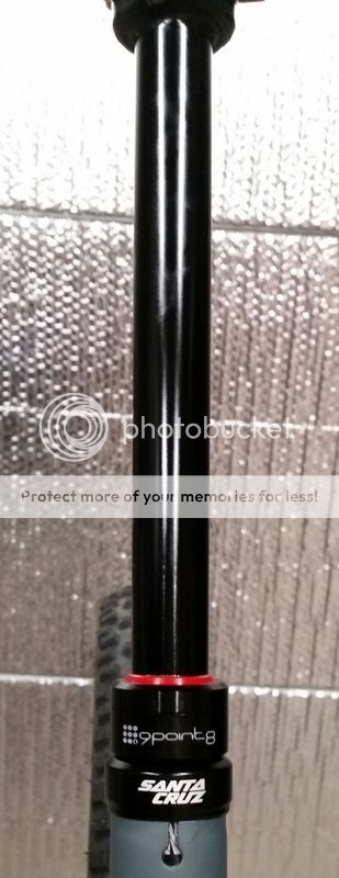

From what I have read from people's opinions is that you shouldn't clamp a dropper post in the workstand. If you do, it should be on the lower part of the post and not the stanchion. However, I brought my bike into the bike shop and they clamped it on the stanchion. I asked them "are you supposed to clamp it like that?" They said your body is heavier than your bike which make sense. However on second thoughts, I don't think there is as much lateral forces on the post when pushing it down with your body as opposed to the bike swaying back and forth clamped on a workstand. So, I am not totally convinced it is safe to clamp it on the stanchion and not sure if the bike mechanics are correct on this one.
Anybody have information on what manufacturers have said or input if it is safe to clamp your dropper into a workstand?

My seatpost clamp and seal head of the post are very close in size. I clamp right at the seal head and seatpost clamp. I've used a clean rag on the sanctions before but it's not something I want to risk. Weight is not the issue, scratches are.

Yeah, I think the risk is more from scratching the stanchion than anything else, though I suppose the lever force of the weight of the bike when the stanchion is clamped can add wear to the bushings internally. Still, I think the primary risk is from scratching the stanchion.
I tend to clamp on however much of the lower part of the post is exposed on my bike. Which amounts to roughly half of the area of the clamp itself. Some of it touches the stanchion, but I'm not squeezing grit onto that stanchion.
I cringe a little bit when a shop clamps the stanchion of my dropper into the stand with a dirty rag, though.
