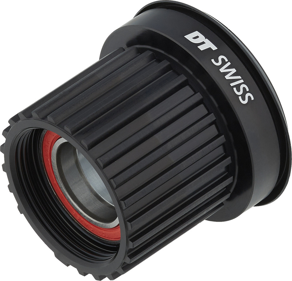

I'm trying to help a friend who had old pawl and spring 18t 370 setup on his 1900 wheelset. I gathered that he had to get a kit that comes with a new free hub driver, 2 ratchets, springs, grease, and seal(s). What's confusing is the exact part number needed and who actually has it for sale. I see several versions of the kit on DT Swiss website but not rear clear on which one to choose. I would like him to get the 36t option w/XD driver. Does someone have a source of someone selling the kit in 36t? Is this the right part# HXYXXX00N7684S

There is an HG, Microspline, and XD conversion kit, and each one comes in steel and alu (the freehub body itself) so you have 6 versions in total. On this site it's pretty clear which one is which part number, maybe it will help?

Thank you. That site breaks it down really well. I can see what part numbers to choose from but it seems they are all 18t versions. I think there is also a kit that will come with a 36t. That would be ideal as 18t would be the same engagement that he has now with the 3 pawl design. No benefit to upgrade. And, you're right; he prob won't need the install tool initially, but I would like to have the tool for future bearing replacements. You have to remove that ring to get to the inner bearing. Maybe we can split the cost.
