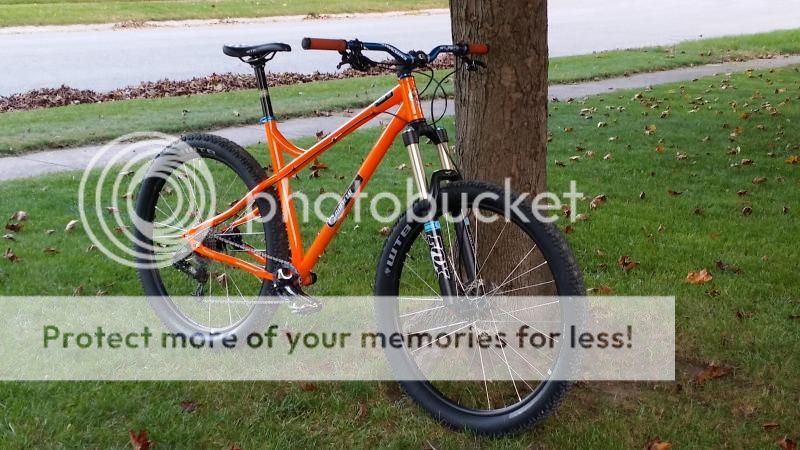

27.5+ WTB Tires and a 2013 Nimble 9= Fun as h_ll!!!!!..Updated with final pics
With the new tires sizes coming out for the new year, I decided to play around with my N9 build. Picked up a set of WTB Trail Blazer 2.8" tires and put them on my Blunt SL rims. Not the ideal set up but gave me a good idea where this would take the bike with the proper 50/51mm rim. It has really changed how the bike flows and reduces the rear end bounce when hitting the ruff sections. I will definitely be getting the wider rim as soon as possible. There is about .25" tire clearance on the driveside chainstay. (the tightest area) This has taken a fun bike already and elevated it to a unreal ride! As built below using a 150mm 27.5 Fox Talas the BB height is 12.25" running 170mm crank arms. Plans are to put a 3.1" tire on front and leave the 2.8" tire on the rear..

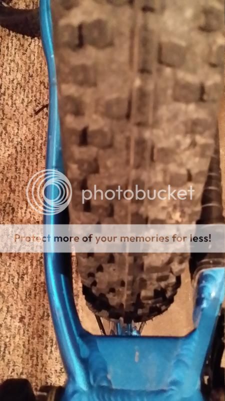

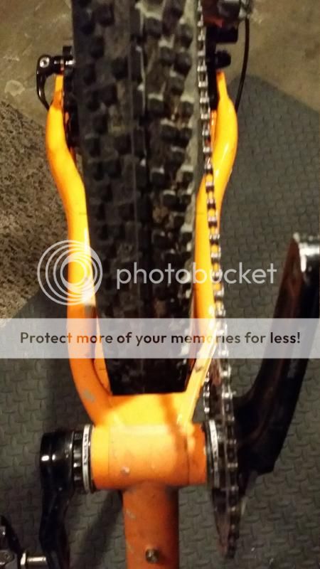

OK....Here we go...
Mounted the 2.8 WTB Trail Blazers to the Velocity Dually 27.5+ rims. Rims measure 39mm inside and 45mm outside. At 20psi they measure out to be 2.7" wide per my calipers. I mounted the wheel into both my 2014 Yelli Screamy and my 2013 Nimble 9... both bikes had about 6mm clearance on the drive side and 8mm on the non drive (@ 20psi). To be honest, if you want wider then you should go with a true fat bike. This appears to be a nice middle ground which will increase traction and reduce the trail chatter prone to hardtails.
