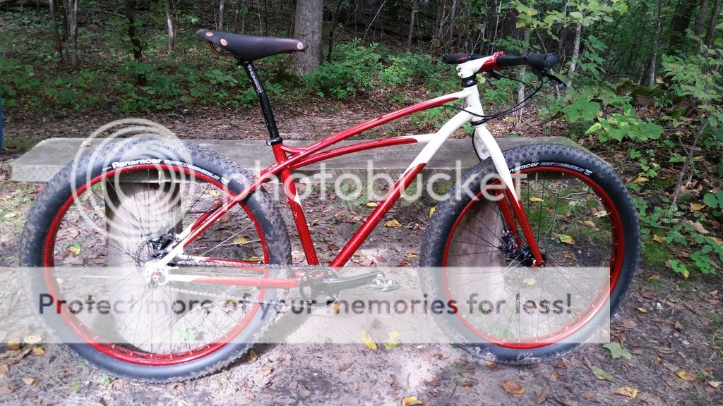

Tires: Panaracer 27.5" x 3.5", 120 TPI, folding
Rims: Velocity Blunt, measured 28mm outer width with my digital calipers
Tubes: 29" Specialized
Frame: Performance Access XCL 29er frame (2010) 17"
Fork: Surly Karate Monkey (2007?)
Comments: this older fork has the V-brake bosses on it, and had to deflate the tire to get past them. The frame has a lot of clearance, probably because of the flattened chainstays. I wouldn't worry about mud clearance on this frame.
B+ by Rickyd, on Flickr
Frame: Jeff Jones titanium 3-D SpaceFrame (2008, Merlin-made)
Fork: Jones Truss Fat Fork
Comments: There is less room between the tire and the chainstays compared to the Performance (above). If trails were muddy, I probably wouldn't ride it... but I wouldn't be riding muddy trails anyways :) Seriously, I'd be more concerned if the wheel needed to be trued. Re: the front, it's a 26x4.0 45Nrth Husker Du. The front fork will easily swallow a 5" tire for dinner, so a B+ would be a piece of cake.
Jones Spaceframe (B+ Rear, Fat Front) by Rickyd, on Flickr
I haven't had a chance to put many miles on either set up, but my short singletrack test track down the block showed me that both setups should work fine.
