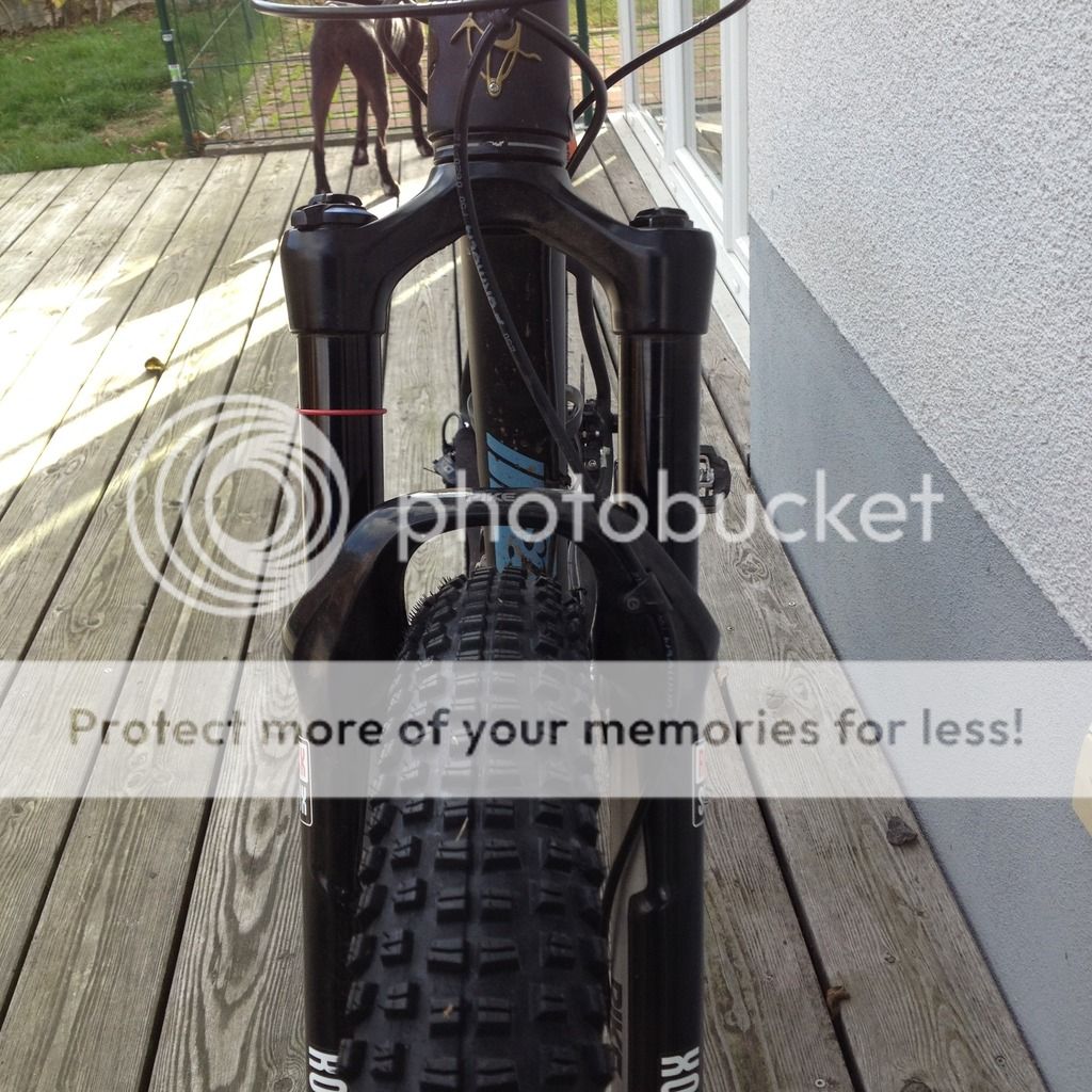

My New Fox 36 showed up and the TrailBlazer 2.8 fits with room to spare when on the WTB i45 Scraper rim. Now my Heckler frame just needs to show up and I'll be set :)

B+ Heckler
Hey Guys,
As promised, here are some pics of my new SC Heckler set up B+.
I had ordered new rims and hubs to build up some normal 650b wheels, but decided to try the bike with the WTB i45 rims first. I am sure glad I did.
On that same note, I didn't order B+ specific tires, but used the WTB Breakout 2.5. It has a smaller b2b compared to the TrailBlazer 2.8, measuring between 60 and 62 compared to the 65 of the TB. Overall, I think I actually like the Breakout better. The tire casing is much more square, and the tread pattern has a nice round shape. Talk about traction and wanting to throw your bike into super techy descents!
The knobs are huge, and are nearly inline with the sidewall casing. If you have been on the fence about B+ tires not being meaty enough, I would highly recommend going this route. The tire measures right at 28.25 inches tall. I will get a width measurement and edit the post
Dusty: those tires seem to be blurring the line between 27.5 plus and non-plus.
Really they're just a meaty 27.5. My Conti TK 2.4 are the same height - honestly maybe even a millimetre taller - but the Breakout's are definitely wider.
For reference, the Trail Blazers are about 13mm taller (about 1/2 inch) than the ones you have on here: they're 726mm compared to what you have measured the Breakout's (713mm/28inches).
I've got the Breakout on the front of my ride right now, and while its a great tire, its heavy. I hope to see more 2.8 tires that are bigger than the Trailblazer 2.6, lighter than the Breakout 2.5 but still small enough to fit the arch of a Pike 275.
I think the Trailblazer will be about as big as a tire that will clear the 27.5 Pike.
WTB tells me they've tried it and it JUST clears (height wise) but they say they do not recommend it because it is such a close fit.
