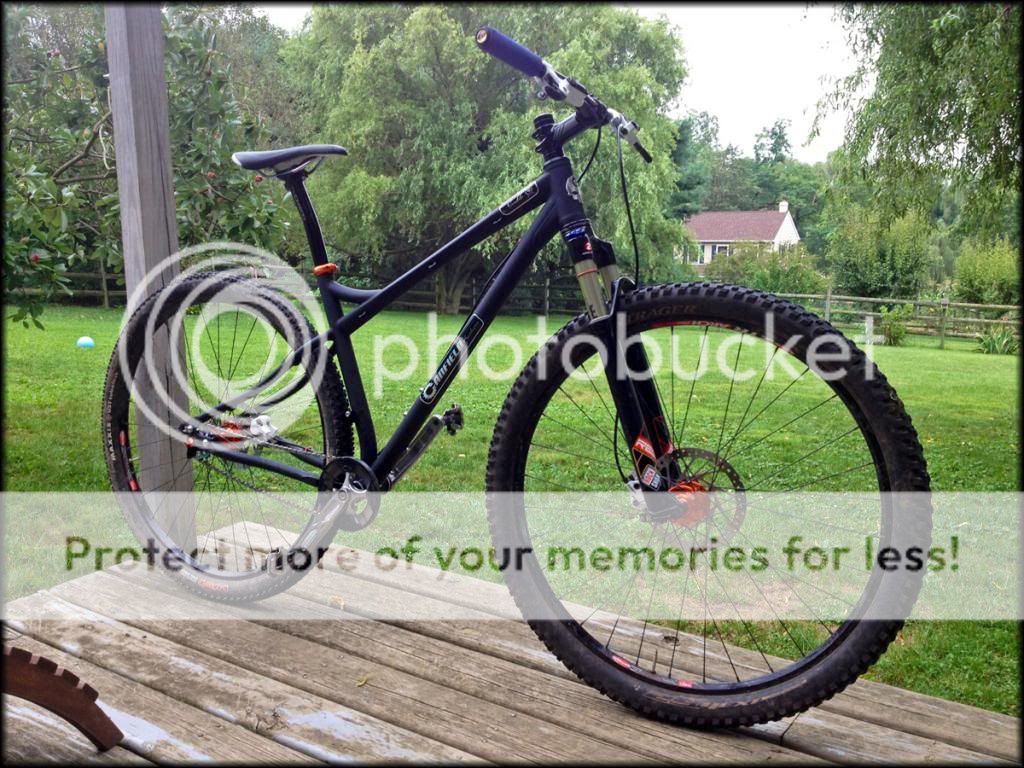

Finished the built up last night and just took it out for a quick shake down...too much fun!!!
My first 29er and first singlespeed so it's going to take minute for the legs and the lungs to catch up with the brain but so far so good, really diggin' the ride so far.
Frame: Nimble 9 Med - Sparkle Blue
Fork: White Bros Loop 120mm
Headset: CaneCreek 40 Series
Crank: Sram XX1
Bottom Bracket: SRAM GPX
Chainring: MRP Bling Ring 32T
Pedals: Shimano XT M780
Cog: Kick-Ass-Cog 20T
Chain: KMC K710SL
Brakes: Elixr R - 185F/160R (Soon to be replaced with a Hope Evo M4/X2 combo)
Seatpost: Cheapo Giant
Seat: WTB Silverado
Stem: Sunline V-one 50mm
Handlebar: Race Face SixC Carbon 785mm
Grips: ODI Rogue lock-ons
Wheels: WTB Frequency i23, Hope Pro 2 evos, DT Comp spokes
Tires: Specialized Ground Control 2.3 F&R (May swap the rear out for something a little smaller and faster)
Weight: A little over 26 lbs on my finely calibrated bathroom scale. I was hoping for 25, but opted for a burlier wheelset/tire combo to better suit the Front Range trails that I like to ride.
