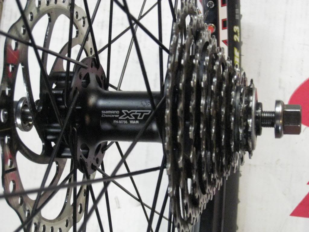

Just got a new bombproof budget wheelset from mikesee with Shimano XT hubs front and rear for a new 29er build. I definately prefer bolt-on, thru-bolt or thru-axle hubs over quick release, but the popular and economical XT rear hubs only come in QR.
Here's a look at a cheap and simple axle conversion.
All you need is a longer than stock axle with nuts (about $15.00), and some cone socket hub wrenches.
I replaced the stock 10x1x146mm hollow rear axle and skewer with a solid 10x1x174mm Wheels Manufacturing axle and two 10x1 axle nuts.
Here's how my poor man's thru-axle kit turned out.
Do you really notice that the rear is stiffer with a solid axle? Seems to me that the difference would be quite marginal since you can only tighten a rear axle safely so much against an aluminum dropout whether it's quick release or solid.
Discussion starter · #4 ·
Like I said above, I prefer bolt-on hubs. That's all.
For riders like me this is a good and inexpensive option.

I hear ya. Inexpensive but effective is okay with me. I have solids on a cheap single speed as this is what works best with a steel frame with track end drop outs to keep the rear axle from sliding around.

Discussion starter · #10 ·
hsakkire said:
Actually, I have done this with the front wheel. I liked this set up with my first generation Reba which can be a little flexy.
It seemed to help.
YMMV :)
I'm doing the front hub soon for a rigid steel fork as soon as I get the parts. Wanted to see how the rear turned out and I'm really happy with it so far.
Are those no turn washers? I swapped them for bolts with normal washers. This because I found that there where only a few threads engaged with my solid axle (surly axle and surly no turn washers). When looking at the pictures I see that the ends of the axle are quite deep in the nuts. Hopefully enough threads are engaged.
Discussion starter · #12 ·
Those are Problem Solver axle nuts with attached washers that spin. They're a little too thick so I'm going to replace them with narrower ones made by Wheels Manufacturing.

Whatever difference in stiffness exists in favor of one or the other, it will be very, very small. What could potentially be noticeable is a large difference in the clamping force holding the dropout flat against the hub end caps, and so allowing less flex between the frame and wheels

i recently had to convert my ultegra road hub back to qr from solid axle because i found the hub would not stat adjusted properly with the solid axle.
i did it to make a more solid ss hub but just found it wasn't worth the trouble.
after removing the hub a few times i would often times find the bearings overtightened.
i am not saying it won't work for you but it didn't for me...
There shouldn't be any difference between a bolt on and QR, once the lock nuts are tightened up against the cones the only way a hub can "tighten" is the cones coming loose from the lock nuts. This would usually indicate that things were not tightened enough.
It should be noted that you do adjust the bearings slightly different for a bolt on than a QR. With a bolt on you should adjust them so there is no play but still turn freely...where as a QR you adjust them to have a hair of play in them.
