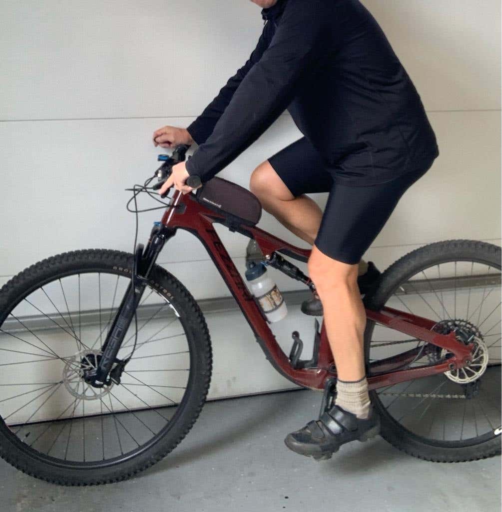

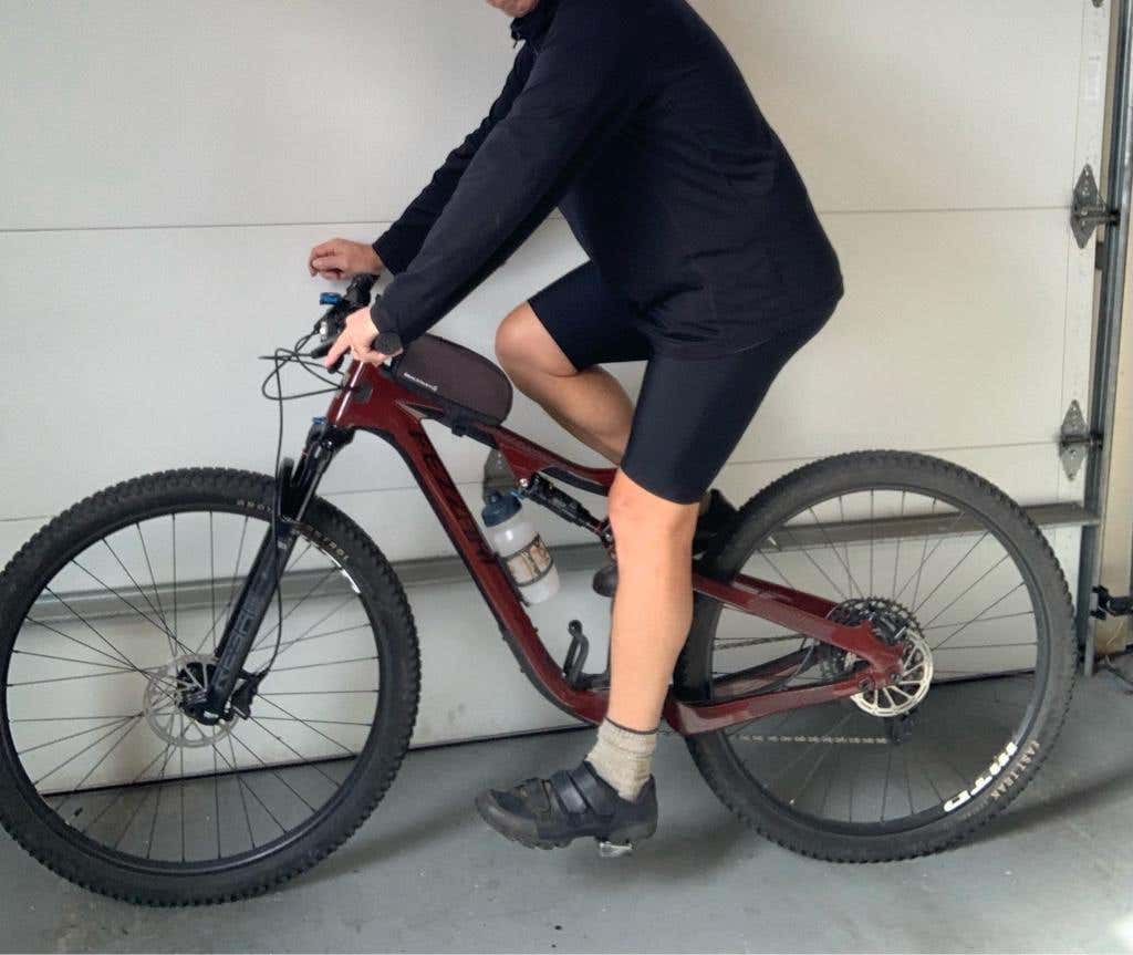

Have you injured your right hamstring in some other way? When you say a ton of problems, what specifically?
I know you are balancing yourself against your garage door but it almost looks like you are a little stretched out considering the cockpit doesn't necessarily look long for you....how much height do you have in spacers below the stem?? I truly have no idea or expertise, but if your position was pulling you forward (i.e. you would benefit from a higher stem) that could theoretically manifest itself in your hamstrings. I think.
Yea cockpit looks tight and bike looks a tad small. But I think everyone looks too big for their bike. Lol.
You cannot afford to have riding induced pain, left un-addressed you could end up with cronic pain that may take many months to heal and a tremendous loss of riding. The sooner you fix it, the less your riding will be affected.
My wife and I each had a professional bike fitting last year, her first ever and my second, the first being 35 years ago. I have done a ton of reading on fit over the decades, watched more than a couple YouTube videos and the result of all that was that we were 'pretty close'. But, both of us experienced big improvements in 'on bike' feel after a pro spent hours on each of our set ups. We are now more comfortable and have a feeling of efficiency that we never had before.
Second suggestion. Yoga. 2-3 times a week for 20-30 minutes of beginner level yoga will start to loosen you up and balance out the front / back, left / right of your body. Listen to your body and don't over do it. But do it.

I tried to figure out the angle of my knee bend. Problem not entirely accurate, but worth a shot.
The suggestions of a “knee angle of 25-35%” seem confusing because I’m not exactly sure where to measure the angle.
I’m trying to post a photo with a protractor overlay but I’m having technical issues.

Correct fit should be measured at sag. No good fitter will use formulas, instead they will check measurements via motion capture while you're pedaling.
Also the heel method does account for sag because the bike is sagged when you're measuring that.
