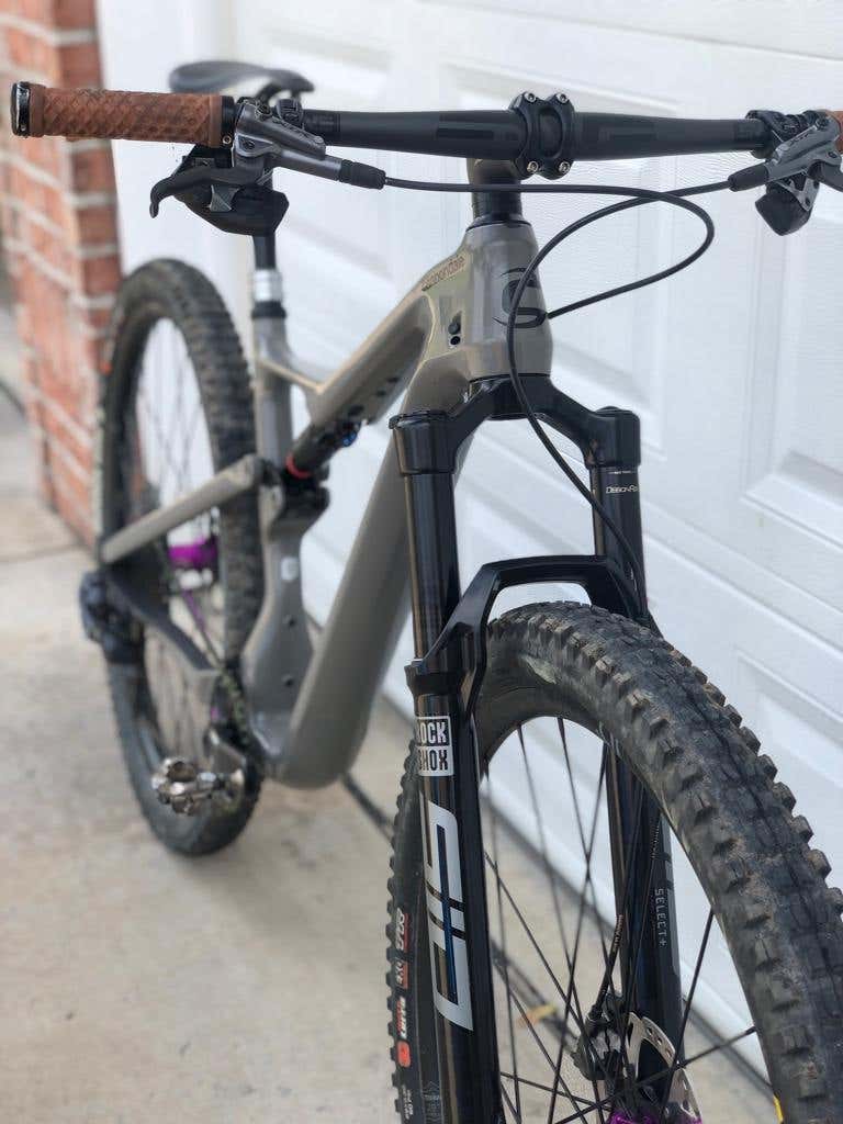

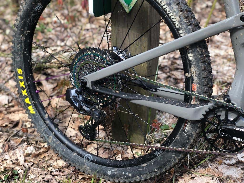

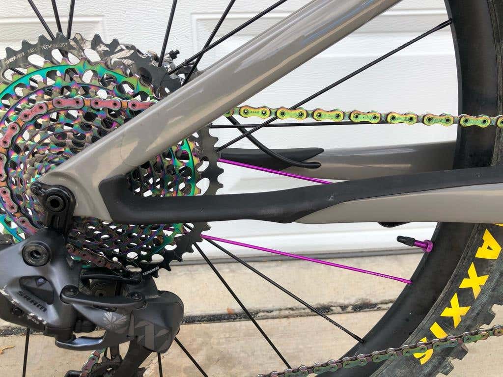

For what it's worth I just completed a build that started as a SE2 at 28lbs and finished at 21.67lbs. Only reused the frame, rear shock, and tires though.
