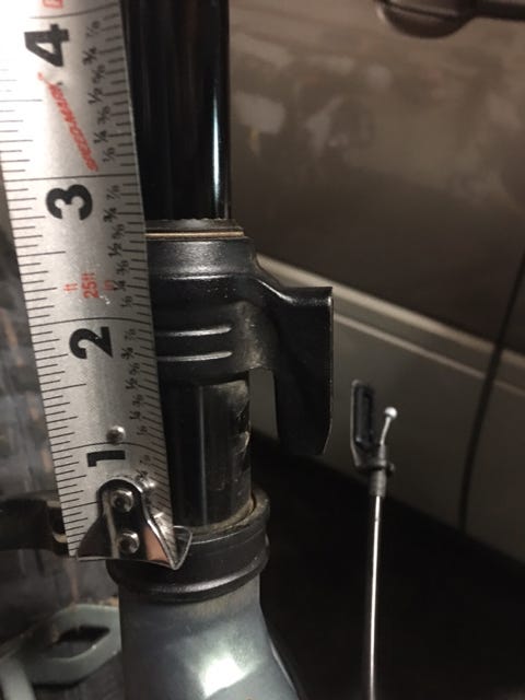

I have a frame with 190mm of possible insertion before a bend in the seat tube, but I need enough exposed post at full extension that to accommodate the full dimensions, the best solution available to me to achieve the maximum drop was to use a 150mm Oneup post (V1), and shim the travel down to about 143mm. It's just plain impossible for me to get a dropper post with the collar slammed AND to be the correct length at full extension on the frame I have.
So, my seatpost collar is a decent bit above the seatpost clamp on the frame. It is what it is.
