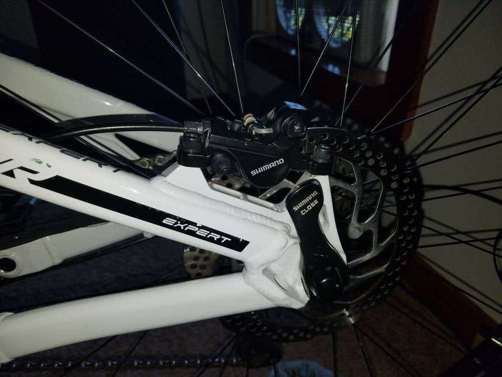

No problem, Shimano adapters are pretty straight in my opinion.
But as I said, make sure you have enough frame clearance.
Sharp rotating hard steel rotors can cut through aluminum frames like butter, at least 5mm to be safe due to frame flex.

Discussion starter · #9 ·
Looks like it's going to work I put on these new ice Tech rotors getting rid of the resin pad only Factory rotors.
I just pulled the front rotor off and tried it on the back since it's center-lock it's very simple to do my other rotor should be here Friday.
If anyone sees anything wrong with this please let me know[emoji6]
I do see other examples of this kind of mounting on an image search on Google so I'm hoping this works out.
By the way it spins smoothly the brake works fine it actually bolted right up no problem not a bit of noise.
Thanks duane[emoji111] [emoji2]
