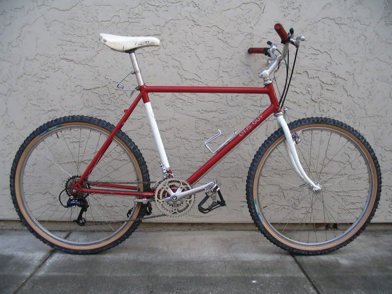

I bought the bike from the second owner. My understanding is that the original owner was a local fireman (hence the color scheme) and at some point it received the treatment that vintage mtbs get all too often....slicks and 'updates'.
Photo from the seller.
The first thing I did was put some First Flight Bikes Timbuk II's on it.
While the tire swap was helpful, the cockpit wasn't anything that really made me want to ride the bike. The rear derailleur was wrong for the bike as well.

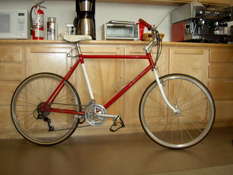

I took the bike up to Mike Varley at Black Mountain Cycles to correct some of the build and give the bike a tune up. While I was there, he said a customer had brought in a box of old parts he didn't have a use for anymore. In the box was a stem that looks like it'd work on the bike. It was a red fillet brazed Steve Potts Goose Neck stem. The color and fit was so perfect that there was no denying that it should be paired with the Otis. Talk about flat out luck.
Along with helping me procure some equally rare WTB/CC Sausage Links, converting the Otis Guy to drop bars completely changed the nature of the bike.
