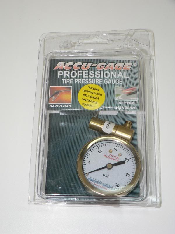

It doesn't read no matter what presta valve I put it on. Stans, forte, specialized, bontragger. It would appear that there might be something missing in the chuck which would depress the end of the valve down to release air into the gauge. I can put it on and take it off and never hear air movement. The clear rubber sleeve only allows a valve about 3/4's deep and can never bottom out against the back of the chuck body, releasing air.
The gauge does read if I hook it directly to a pump, so the dial isn't defective.
What am I missing?
This is what I've got:

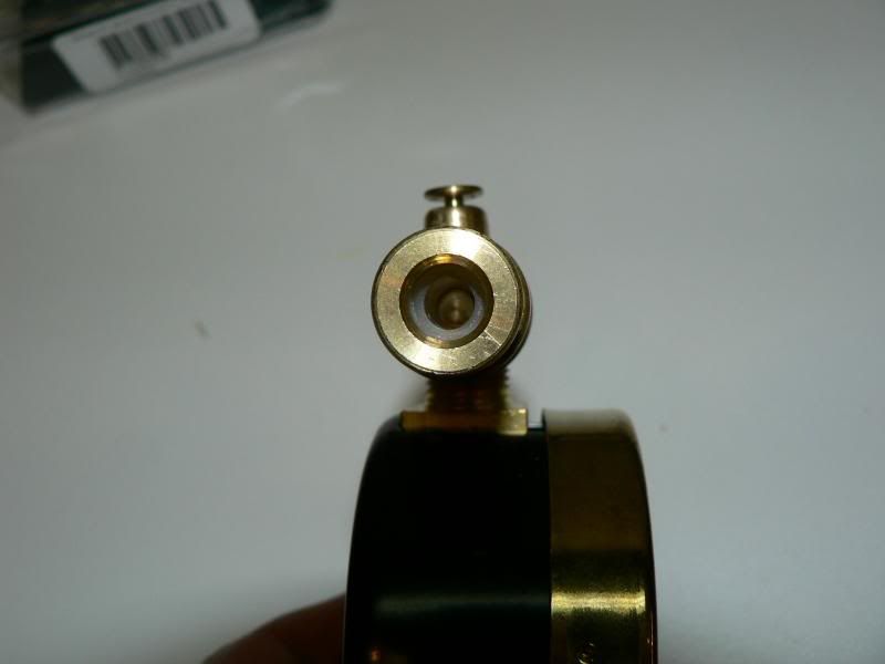

As you can see below the gasket stops at the larger threads where the nut turns on. At that point the tip of the valve is within the gasket with nothing to depress it letting the air reach the gauge.
Is it too hard to push it all the way over the larger threads?
It can't get as good of a seal around the threads as against the tapered part between the small and large threads, but that is how some of them are designed to work. they usually use a softer gasket for that though.

Without the brass collar on it the gasket presses over snugly and the outer diameter expands. Once you put it inside the collar there is no way to push it down since there is no room for it to expand. I tried it separated from the gauge body so I could see the valve tip and it still comes up short.
I guess I can try running an oversized drill bit down the inside by hand to see if I can shave a bit of the material away.
I would try pushing harder before using a drill. It can't expand inside the collar, but the material should give way, and shear off a little at a time until it fits over easily, then over time, more will wear off, until you need a new one.
If it just won't go, it may be too hard from sitting on a shelf for too long. Maybe try to find some rubber hose the right diameter and thickness, and cut a short piece to replace the gasket.

Update: I removed the core from an old valve stem and pushed the larger threads as hard as I could into the gauge to hopefully crush the gasket down. Broke some blood vessels in my palm and left an outlined ring of the stem that lasted a couple days. Let the gauge sit like that for a day or two. When I removed the old valve it must have worked some because I was able to get the gauge to slide on far enough for a short enough burst of air to take a reading. It still does not stay set in the deep position because bleeding it off only let out the air trapped in the gauge. Had to jamb the gauge down again to take another reading from the tube.
I assume after a few days sitting w/o a stem lodged inside that the gasket will go back to it's original shape. I'm probably going to try and over-drill it.
