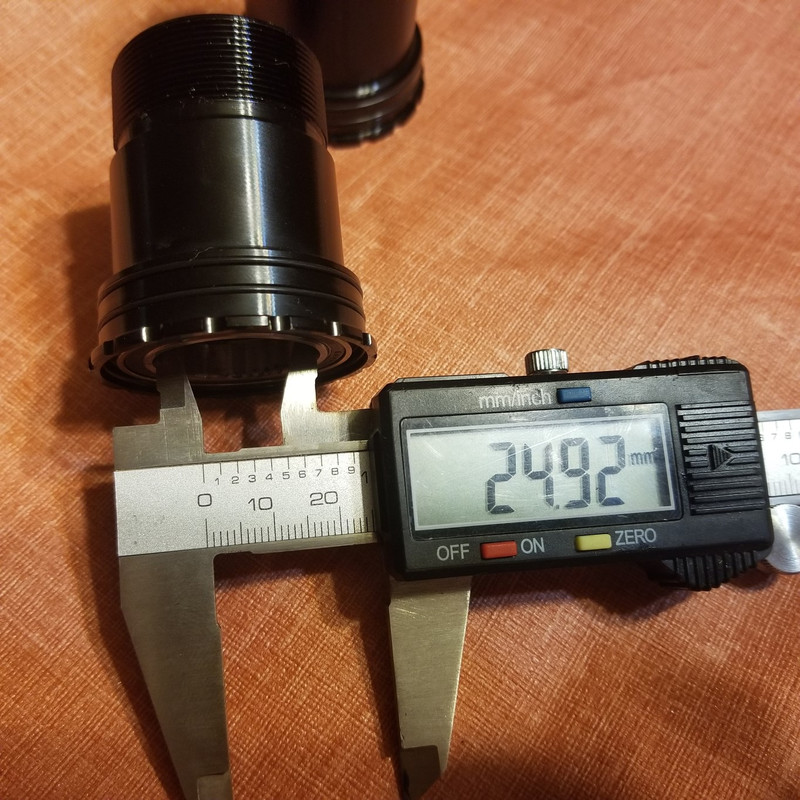

Outer diameter is within a hundredth of a mm of my Wheels Mfg unit.

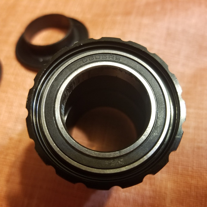

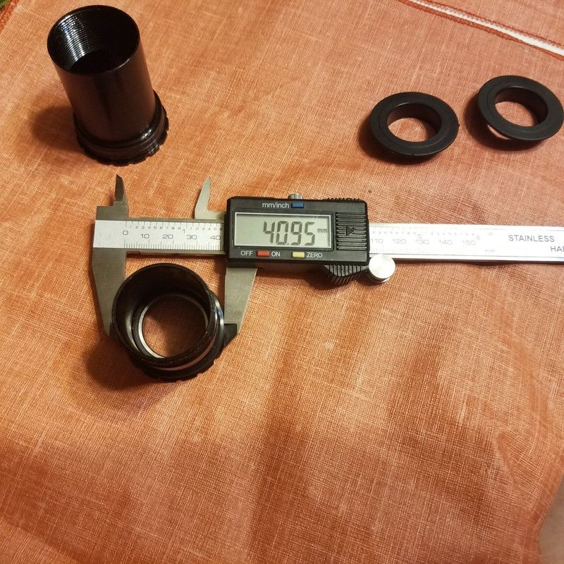

Now here's a problem. This comes with 6805 bearings which are almost 25mm inner diameter. Shimano spindles are 24mm and bearing i.d. for PF92 is 24mm. They made up for this by including these cheesy plastic shims you've seen in the pics, BUT these spacers/covers have no seal. I want to use a better seal. So I pressed out my Enduro angular contact bearings from my Wheels unit and put them in the ZTTO. Problem solved.

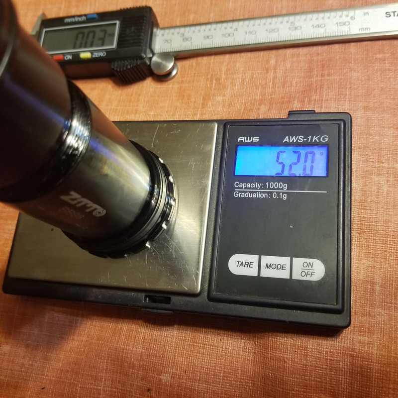

Shell weight without bearings is the same as the Wheels.

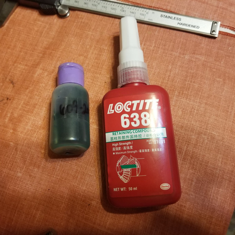

But which retaining compound to use? 638 says it's high strength and permanent with a 4ksi strength. I used that for the bearing/shell interface. 609 is medium strength at 2ksi for removable fittings. I used that for the shell/bicycle interface.
