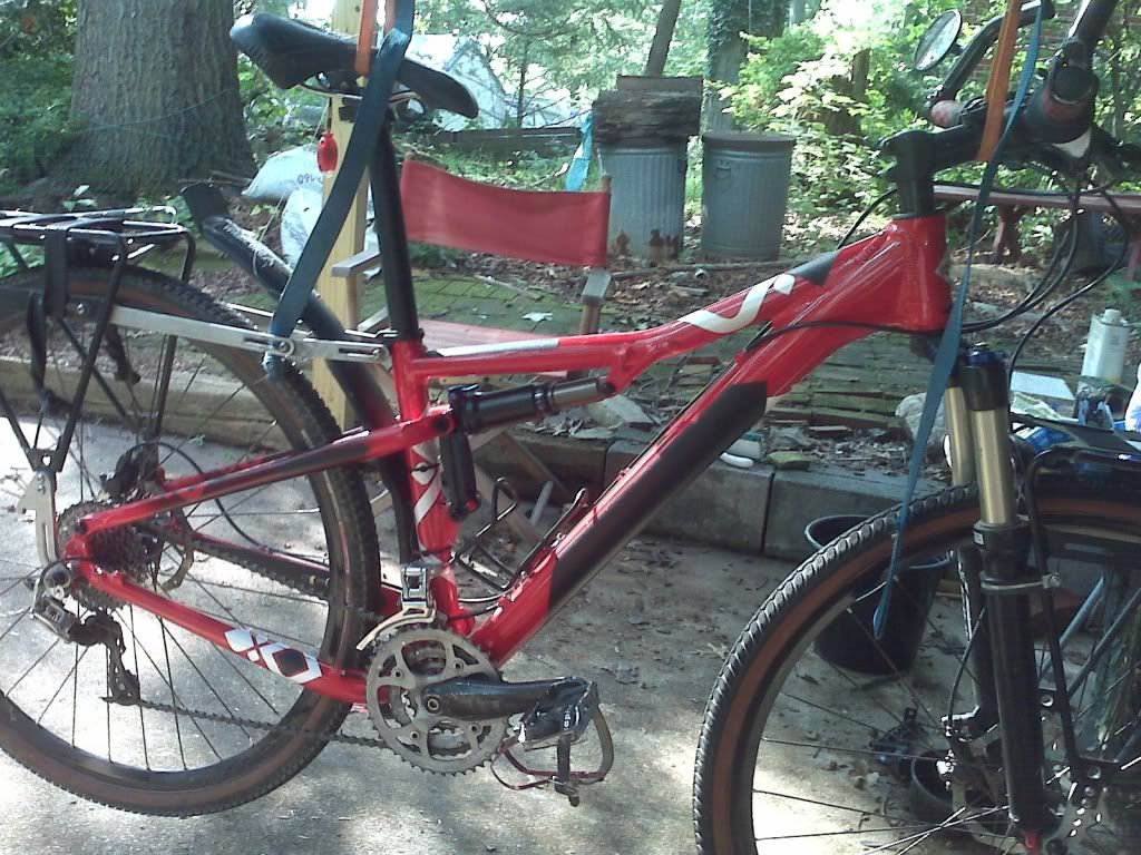

I'm ordering a new bike since my much beloved Hi Fi was stolen and while I like the 2/10 setup, I much prefer the twisties.
This is what I'm greiving
